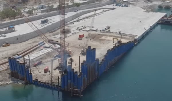

The contractor is installing a long line of contiguous steel large-diameter tubular piles linked with clutches/ interlocks (terms used interchangeably in this part of the world) welded directly to the piles. The piles are driven into position. The pile diameter is virtually the pile C2C spacing.
High strain dynamic testing is being used to ensure that the driven pile's capacity is satisfactory under service loads. The testing is occurring to individual piles. The piles will be loaded as a group.
My concern is that the tested pile is possibly being supported during high strain testing by clutch friction to the adjacent piles and by the soil between the loaded pile and adjacent unloaded piles. In service, the piles will loaded simultaneously, so there won't be support provided by adjacent unloaded piles i.e. no clutch friction and the soil shear perimeter will basically be parallel to the pile wall = shorter. If so, the 'real' pile capacity in service may be lower than the capacity assessed during high strain testing.

The contiguous tubular piles form a quay wall around 400m long and support large rail-mounted quay cranes.
