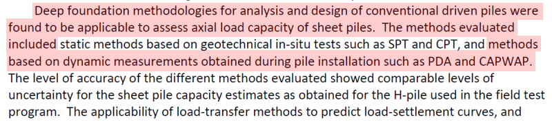

Like PEinc, I didn't expect to find test results on dynamic evaluation of interlocked piles... but something very close showed up:
"Determination of Vertical Resistance for Sheet Pile Abutments", R&D report for the North Carolina DOT.
Here is an excerpt from the executive summary:
Thanks SRE, that paper looks very interesting. I have some more homework to do.
Nice find, SRE. However, I had a driven H-Pile project a few years ago where, in our pre-driving discussions, GRL did not recommend using their WEAP or dynamic analysis for capacity of vibrated H-Piles. I assume that their reluctance would be even greater if vibrating sheet piles.
PEinc - Like you, I was taken aback about a vibratory hammer being used. To my knowledge, there is no dynamic testing that gives satisfactory results with that type hammer. Then, hidden away on page 41 of the report was this one brief sentence that removed the problem:
That made sense and was in line with common practice, set the pile with the vibratory hammer, then switch to the impact hammer for final driving and dynamic testing.

SRE, GRL told me that, although their WEAP program includes vibratory hammer analyses capability, the process isn't refined enough for use. I am surprised that the paper you found does not discuss problems associated with interlock friction and effects of interlocked, adjacent SSP during capacity testing.
Yes, I suppose the omission is because of the study's goal is to see if sheet pile can replace HP for bridge end bents.
