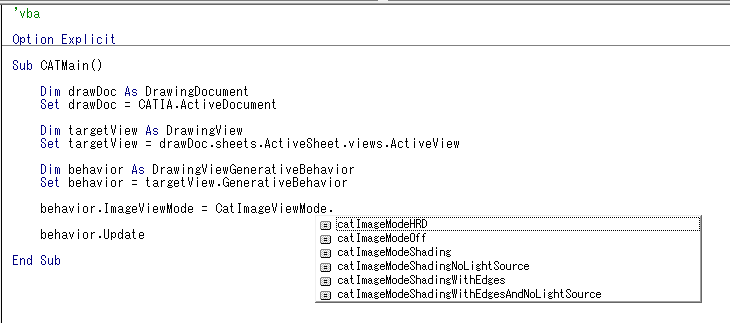

Hi AlvaroPers.
Try this.
Code:
'vba
Option Explicit
Sub CATMain()
    Dim drawDoc As DrawingDocument
    Set drawDoc = CATIA.ActiveDocument
    Dim targetView As DrawingView
    Set targetView = drawDoc.sheets.ActiveSheet.views.ActiveView
    Dim behavior As DrawingViewGenerativeBehavior
    Set behavior = targetView.GenerativeBehavior
    behavior.ImageViewMode = CatImageViewMode.catImageModeShadingWithEdges
    behavior.Update
End Sub

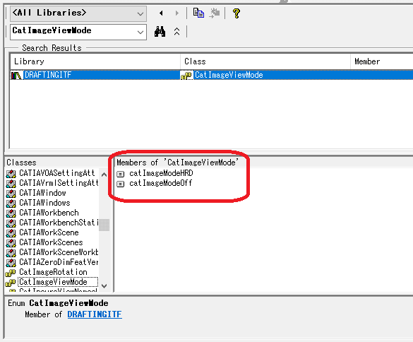

Hello kantoku,
Thank you for replying,
The only options the generative object offers to me for ImageViewMode are: "catImageModeHRD" and "catImageModeOff"
There is no "catImageModeShadingWithEdges"
Did the code work for you?
Please, let me know,
Thank you

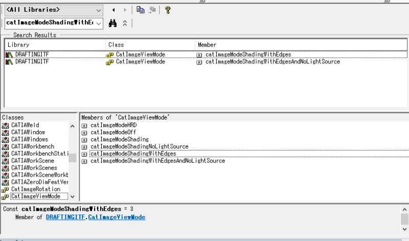

In my environment it shows 6.
Is it a licensing issue? I am using HD2.
Interesting that I just have 3 constants, and you have 6.
I have HD2.
I'm using Visual Basic under Visual Studio 2022. See the attachment.
The namespace is DRAFTINGITF, so it's the same as yours.
I don't know why I don't have the others constantans.
I'm gonna make a try using a different environment and see what happens.
 https://files.engineering.com/getfile.aspx?folder=47d063e0-0014-4a5f-96f0-dad9734e28d7&file=Capture.PNG
