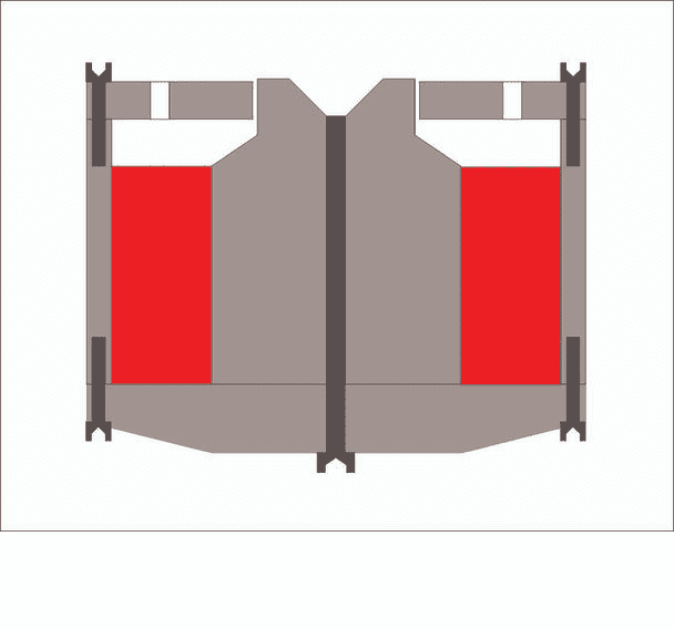

in the attachment you can see, in section, how the magnetic motor of a field coil loudspeaker is made.
you see a central body, an empty red space where the copper wire winding and a double outer ring are placed to close and channel the magnetic field.
the idea is to use the central core in the shape of a cylinder wound by the coil with hiperco 50 to obtain maximum magnetic saturation, then the outer ring with another metal, also because hiperco 50 is expensive and difficult to lathe.
I also thought of using mu-metal but it has a very low magnetic saturation. in reality it is not clear to me how the two quantities (saturation and permeability) of the outer ring must be in order for everything to work at its best.
why do you say that it takes so much current for hiperco 50 ? looking at the BH curve it doesn't seem like it to me.
I searched the net for the magnetic characteristics of permalloy 49ni but I didn't find anything, where should I look? .
Could using low carbon steel and then annealing it to increase the magnetic properties be a good idea? .

Hiperco 50 is often used for aerospace and thin film chips where the limited space is key. if your speaker has enough space, no bother to use FeCo. low carbon steel (electical iron) and low si core iron have as high as B at 21kG, normal Si Steels at 16-18kGs, Hiperm 49 (commercial name for 49Ni) 16kG, Mu-metal (other commerical name Hymu 80) 7.5kG.
Hymu 80, max DC permeability can be as high as 600,000! it also owns some degree of corrosion resistance. if corrosion is key, you could also think about ferrite stainless with B up to 18kG.
among all these soft magentic materials, hiperco has loweset permeability, which means you need a much higher current to get the same B level. note, flux = B.S, for a same flux, you can either increase B, or simply increase cross section area S if your applications allow.

depending on quality of the steel, it varies a lot. if you use "soft" iron with super low carbon, you need a field of 1,000 A/M to reach 2T, while Hiperco needs 5,000 A/M to get this point. If you apply a field of about 20,000 A/M, you can get 2.4T from Hiperco, however no gain on iron after saturation at 1000a/m.

2T may be enough for me, plus with 1,000 A/M I can save energy. for the central body I therefore choose low carbon steel. now I have to understand which steel I have to choose, there are already two candidates who are:
- 1001ELI (EDDS) .
- ARMCO purified.
which of the two is better in your opinion? .
it remains only to understand what material can I use for the outer ring and with what characteristics, I think it must have a saturation at least equal to that of the central body, but the permeability instead?.
however, other problems arise later, the two formats of semi-finished product that I need are the full round with a diameter of about 10 cm and the tube with an internal diameter sufficient to contain the full round, we need to see if the two steels I mentioned are marketed in this way. alternatively I could find a small forge that melts the metal, and also use it to do the annealing.

RE: magnetic field and two metals
Which part are you talking about?
The flux density will be different in each section so the demands on the material will be also.
What non-magnetic material are you using for the back plate?
You don't want powder.
Unless you have dies, high pressure presses, and hydrogen sintering furnaces you will never get close to full density.
You need to find steel bar a size that works and with less than 0.02% C.
Machine and anneal (conventional).
Then test. If you need a bit more then try a purification treatment.
high purity 4N or even 5N does NOT mean much here. it often only indicates total metal impurities tested by GDMS. The metallic impurity does not do much bad to magnetics, the gas impurities(C, S, O) do, which are normally tested LECO. what you really need is to get as low as poosible low level of gas impurities to boost the soft magnetic properties. anneal after machining can remove stress, which can also be helpful.
