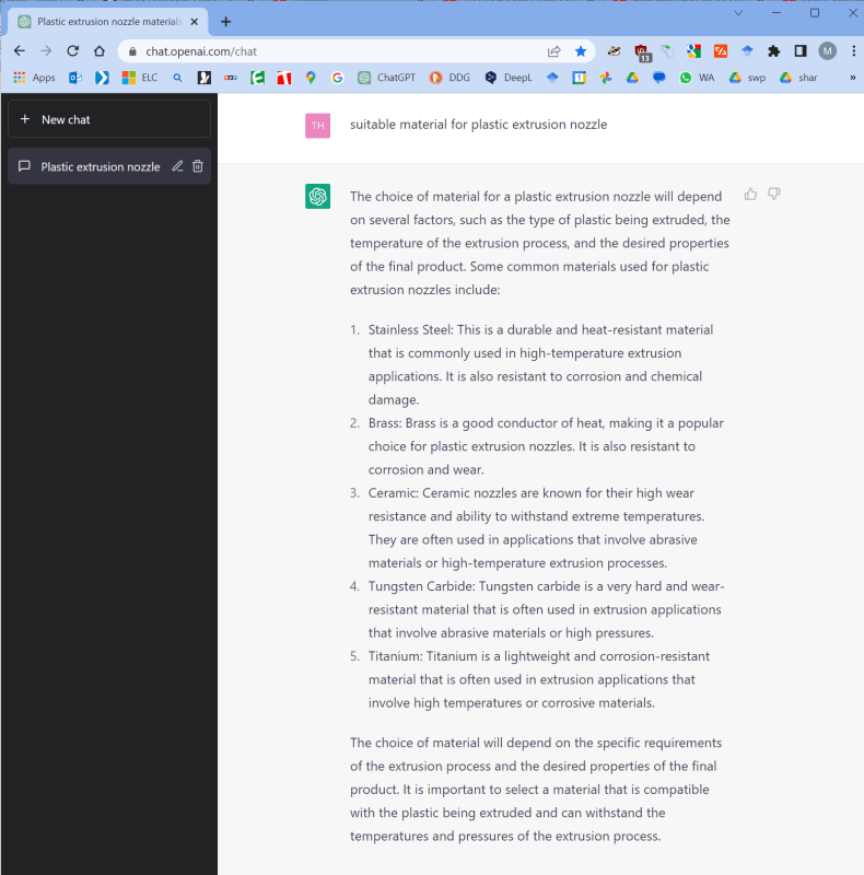

FWIW, here's ChatGPT's take on your problem; note that aluminum didn't even make it to the top 5 materials. I think that even diamond would top aluminum on the list
Note that OpenAI explicitly mentions that ChatGPT can give out wrong information
TTFN (ta ta for now)
IRS... is that a reply by AI? If it is, Wow...
Chat GPT has made it as far as a marketing or sales level conversation. This has ZERO engineering value.
And it's obvious because it makes no mention galling issues of all of the materials recommend (well silicon carbide has other issues than galling).
We have created an artificial politician.... yay.
I didn't say it has engineering value... on first glance, it's quite a package; it had no idea that it had that capability. I'm trying to get my old Win 7 machine up and running (don't know why it stopped) where I have Delphi installed... to compile the Travesty program I just downloaded. I've ocr'ed the above clip and have the text file... I want to try running it through travesty just to see what comes out of the sausage machine...
Barrels and nozzles are not the same thing. The nozzle is at the end of the barrel.
