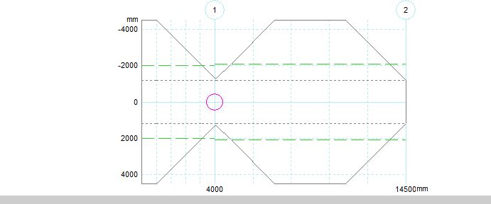

Hi All,
Just looking for some high-level comments or guidelines for modelling large(ish) cantilever in band beam floorplates (in RAM - RAPT is fine).
The floorplate is a 4m cantilever, 10.5m back span with a 9m tributary; a 400dp, 2.4m PT band beam with a 180thk PT slab structure has been adopted. Typical office loading of 1.5kPa SDL, 3kPa IL and 2.9kn/m for facade. Adopting the same concrete grades and PT profiles between RAPT and RAM results in the cantilever deflections that greatly differ:
RAPT: Circa 8-9mm
RAM: Circa 16-20mm
I am traditionally a RAPT user so I may be doing something wrong in with my RAM modelling.
Thanks in advance for any help (i'm sure that the "RAM vs RAPT" question has been asked loads of time)!

Rapt run attached for reference (with the LLR at 1 for comparison to RAM).
This all came about as I completed a concept layout in RAPT and got my Grad to finalise the design who picked up deflection issues in RAM – which doesn’t make sense to me as it’s a relatively balanced system. I did reach out to RAM and they thought it was peculiar that the back-span was deflecting so much in RAPT – which I disagree with – it should and balance the cantilever.

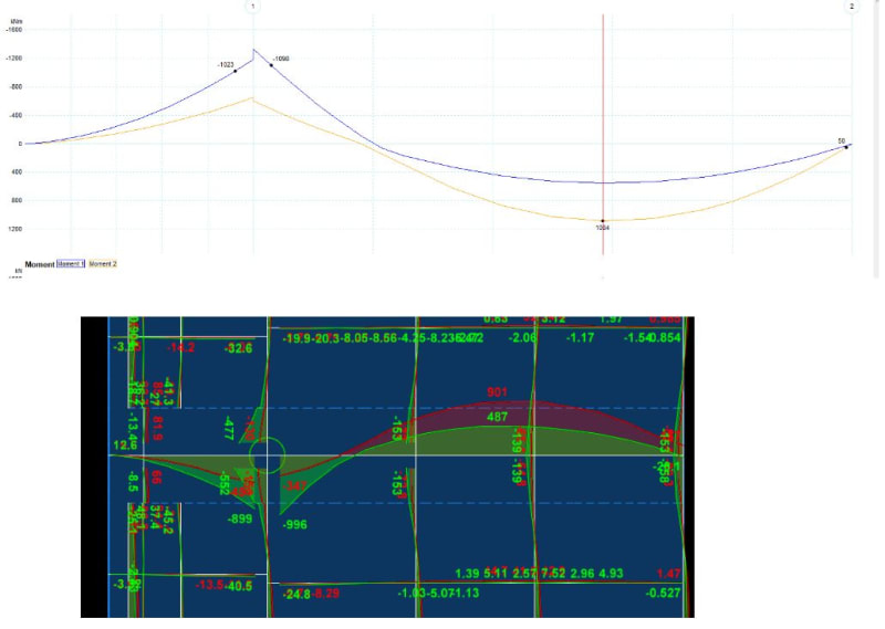

@trenno – BMD and reactions have been reviewed (image attached) and are comparable. This is where we drilled down to the Ig/Ieff values in the LT deflection calcs in RAM. At transfer RAM has a negative deflection of circa 4mm (vs <1mm in RAPT) and the Icr values adopted are <50% (vs uncracked in RAPT) – The RAPT results appear to make a lot more sense to me but now I’m half way down the “RAPT vs RA” rabbit hole and need closure – I’m sure we have done something silly and I’m just not seeing it.
The back span effect is even more pronounced because the section is cracked in the back span at the bottom (about 4MPa tension) while the support region and the cantilever are uncracked.
At transfer, it is fully in compression (minimum about 1.3MPa compression). Hard to understand why you would use a cracked inertia!
I can get those sorts of relative deflections between cantilever and back span if you put a column at the end of the back span! But not with the arrangement you have.
Run it in a frame program without any prestress and check the relative deflections you get just for the applied loads. No prestress, cracking, long term effects etc. 2D or 3D, the relative effects should not change that much.

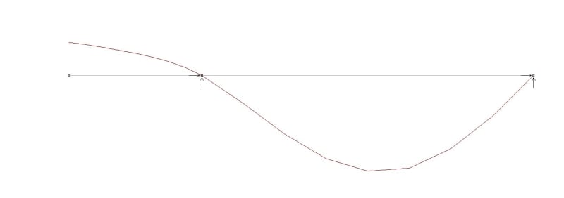

Going back to RAPTs point - a simple 2D frame check illustrates that the back-span balances the cantilever:
Thanks again
That is about what I get in RAPT if there are no concentrated loads on the cantilever and all pin supports. Cantilever up about 1/3 of the downward deflection in the span!
