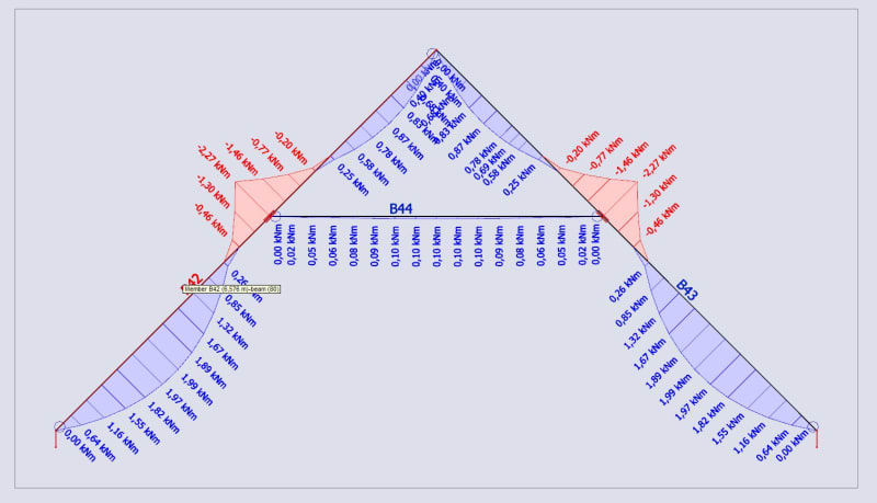

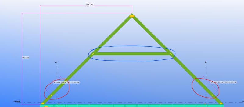

First, a screenshot from my Tekla model for the rafter. The splice is highlighted red, the strut blue:
Next, a bending moment diagram of the rafter. Look at the diagram - the strut sort of makes the rafter a two-span beam, doesn't it? (I know the connection slips a bit, and the strut has some axial stiffness, but still, it supports the rafter near the mid-span)

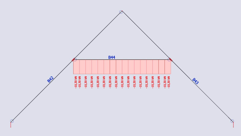

Next, the strut with compression:

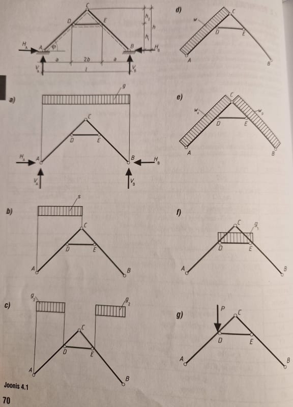

And lastly, a picture from the local engineer's handbook about this sort of rafter:
It is really common around here (Estonia) but not so much in the US it seems. The thing with these rafters is, that the horizontal supports must be rigid enough to take the horizontal reactions, otherwise the strut becomes a tie and the rafter is basically a simply supported beam.

We would generally call those collar ties. And I understand how you think that this may change our opinion. To me, it doesn't. I've seen too many of these rafter roofs with bowing rafters just due to the rafter deflection and creep without a splice. I wouldn't want to automatically introduce a source of flexibility into an already dubious system.

I really don't like the concept of this overlapping connection, but first, the statics. The shear diagram for bolts indicates a different shear value for the two bolt groups. That cannot be correct. The shear for each pair of bolts must be the same for a uniform load.
If the load per meter is w, the reactions are 3.5w at each end. Each member carries w for a length of (7-1.3)/2 = 2.85m and w/2 for the central 1.3m. W = 7w for the beam without splice. Reactions are 3.5w each end.
Each spliced member has a reaction of 3.5w at one end and a moment of (w/2)*(2.85^2+4.15^2)/2 = 6.34w at the splice, so with each bolt group separated by 1m, the shear is 6.34w in each group. In your case, w = 4.42/7 = 0.631kN/m so bolt shear = 4.00kN for each bolt group.
Split rings or shear plates could be used to reduce fastener slip, but eccentricity puts significant torsion in each member between bolt groups which needs to be considered.
