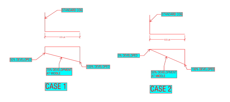

Legoman, I'm assuming that your question is whether Case 1 or Case 2 in this sketch below applies. Have noticed at my own workplace that conservatively in spreadsheet calcs people will assume Case B, tends to have the largest impact when it comes to development in something like a pile cap where you're aiming for high development at the piles which are relatively close to the edge.
rapt, I'm thinking you've interpreted the question as being about the length of the cog beyond standard increasing the development at the bend. You're definitely correct that it doesn't - I believe the commentary also raises what you've mentioned regarding bend radius.

Rapt, I don't think Legoman92 is proposing extending the straight part of the cog and relying on that to provide additional anchorage, which of course it wouldn't.
I think Just Some Nerd got the gist of the question, which is whether the cog provides an immediate 50% anchorage or not. I believe that it does (Case 1 above).
Another case to think about is for a stirrup with a 4db bend. There has been at least one study (happy to dig this out and share it) that shows that small diameter bars used as shear reinforcement can be immediately developed beyond the bend even if there is no transverse bar in the corner. That is to say, the bend can provide 100% anchorage (in some situations). Of course with the transverse bar in the corner, you have the added benefit of controlling splitting in the plane of the bend and also spreading the concentrated anchorage force out over a larger bearing area.
For larger diameter bars, I suspect the splitting/crushing issue in the plane of the bend may become more important, especially where your bends are not oriented in a way that they are exposed to a compressive force like a stirrup hook at the top of a beam. But the commentary seems to say that you can rely on 50% immediate anchorage in these cases.
Yeah basically I'm saying the straight section contributes the 50%, so Case 1 is my understanding how it works. The difference between the two cases is quite amplified when you're looking at large diameter bars

this is interesting - i have read the above and the code again a few times and with the benefit of Just some nerd's diagram i would have gone with Case 1. I have seen this applied in the design office multiple times and potentially incorrectly (and by people trying to do the right thing not by find a shortcut)
hi Rapt - for avoidance of doubt, are you saying that case 1 above is not the intention of the standard for a bar in tension?
If case 1 is not correct, then if you need full anchorage a standard cog is not all that helpful and you would need to provide a full straight anchorage, some big radii curves or a terminator.
Is the .5Lst length past or before the cog?
My reading of JSN's pictures is that the .5Lst is before the cog. That is ok, as the cog gives 50% at the end of the main bar, then .5Lst further along the bar you get the other 50%. Only 50% of the force is required to reach the cog and the radius of curve is ok for 50% load.

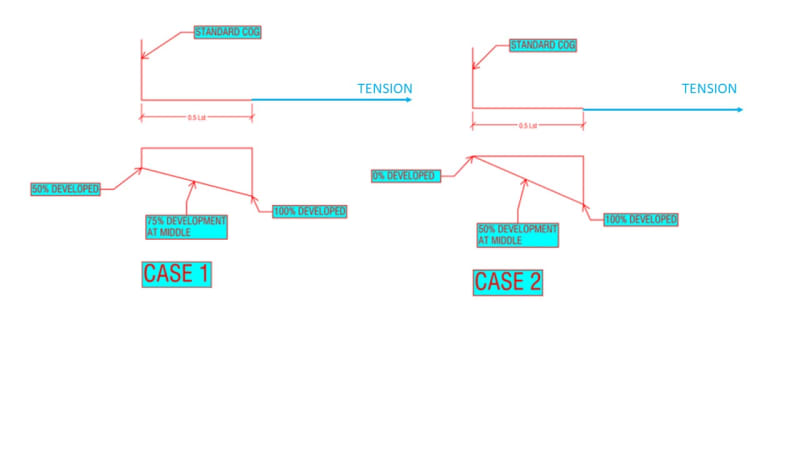

But if the .5Lst is after the cog, then the cog radius must be increased and you get no extra benefit from the cog, the total length must be Lst including the length through the cog. If you were to use the smaller diameter radius in this case, you have the full force through the curve radius and that causes crushing problems in the curve.
Hi Rapt, good question on orientation. I have annotated JSN's image with a blue line to indicate the rest of the bar. This also neatly illustrates the part of the bar I had considered to be fully anchored in Case 1.
From reading your comments, i believe you are saying that Case 1 is correct?
Yes, case 1 is correct, it will provide full development at .5Lst as is shown in Fig 13.1.2.6 in AS3600 and 50% development at the start of the cog.
