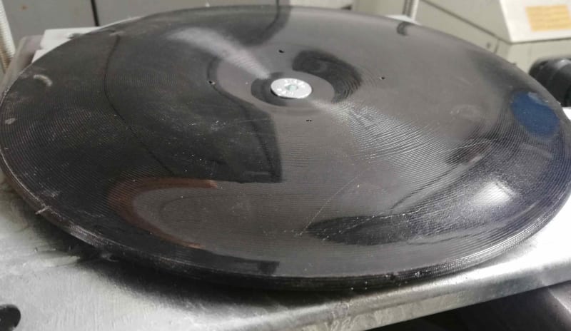

3D printed air bearing casters.
The key feature of the printing process is to obtain a separation surface between the upper and lower faces of the caster, in order to get the flexible
inflatable torus that makes up the caster.
