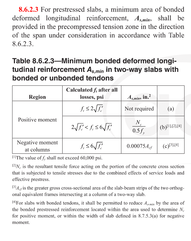

Two questions regarding post tensioned podium slabs:
1) Do you use a bottom mat of reinforcement. It seems that they are fairly common, help distribute loading, and help minimize/distribute restraint cracks. However, if "challenged" do you think they are 'necessary'.
2) You have most of your slab balanced for something around 100% of the slab self weight, but you have a few pesky spans that are longer or more heavily loaded. These will require a large amount of precompression and drape which will end up well exceeding 100% of the slab self weight... Is there anything additional or different you will do to avoid any issues during stressing. For example - You likely need bottom bars over the column (or top bars mid span) to avoid exceeding stress limits at transfer. Anything additional along these lines? Maybe more column dowels?
Thanks!

Whatever your opinion is on the issue, it is my understanding that the ACI does not require a continuous mat of rebar in unbonded 2-way prestressed slabs. If you are finding that you need bottom rebar in the span and over columns, it might improve constructability to simply provide the continuous mat.
For positive moments over columns resulting from over-balancing during the initial stressing, you will need to provide bonded reinforcement per section 24.5.3. You can also consider stage-stressing the tendons so you avoid over-balancing effects.
Check out Tech Note 8: Link. While I understand where rapt is coming from (he is probably one of the two most knowledgeable PT guys on here, KootK being the other - I actually learned most of what I know about PT from KootK); it does appear that bottom bars are not technically required in the US if certain conditions are met with stresses.

This is how I would recommend handling the issue. It is permitted by code, so you should feel comfortable proceeding in that direction. I would recommend using FEM or one of the methods described by rapt to determine the moment and stresses in the slabs due to the non-uniform layout and loading. In the US, Adapt, Ram Concept, and CSI safe are all commonly used software packages to accomplish this task. I do not have experience with Safe but both Adapt and Ram Concept will evaluate the design sections for your transfer stress condition and add reinforcement if it exceeds the code-permitted limits.
