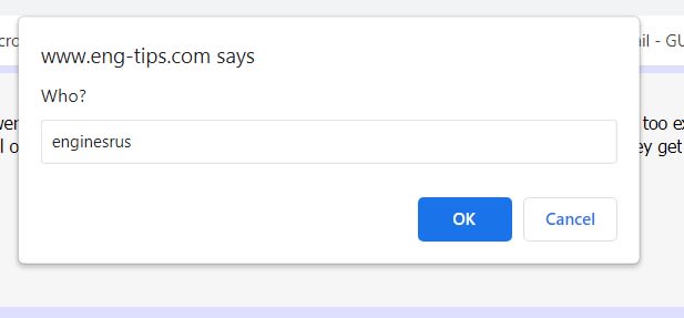

Question? How to do qoutes on this forum?

How to do quotes on this forum?
First highlight the bit you want to quote and copy it (Cntl C)
Then find the little speech bubble icon
Theh a little pop up appears where you type the persons name in
Then in the main box you get this with the cursor in-between the two [ ] [ ]
Then paste in your quote and move the cursor down to the next line or press return after the last ]
If you want to check press preview.
