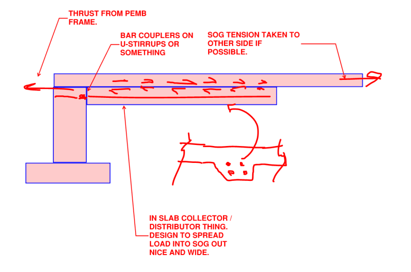

I did some schematic work on one of these buildings earlier this year. It got me wondering if anyone has ever tried the scheme shown below as, kind of, an intermediate position. This would greatly improve the local connection near the thrust and provide a fairly reliable way to spread the tension tie load out across the entire width of the SOG such that, hopefully, there would be improvements with respect to elongation, reliability, and local interruptions in the slab on grade. For all the practical issues associated with a tension tie across the building, it's the most elegant mechanical solution by far.
Whenever I think that I've devised a better mousetrap, it almost always winds up being the case that I don't for some reason. I'm fully expecting someone to point out some deal breaking flaws with this conept.

Nope, for better or worse. I believe that a true, concrete tension tie cannot be lap spliced according to code. Obviously, one does not see a lot of mechanical / welded lap splice in these setups.

Options are essentially limited to a moment resisting footing/pier or a tension tie in or below the slab.
