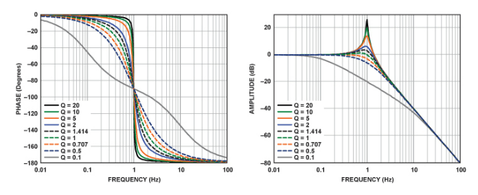

Now when it comes to output, which is much more complicated - it can be expressed in two different forms - magnitude and phase angle or real and imaginary. As I understand, magnitude simply means amplitude of the sine wave of the response. Phase angle is more tricky. Is it just the offset between the two sine waves (load and response) like in the picture below?

And is it true that a phase angle of 180 degrees corresponds to the case when sine waves are opposite (when one is at its peak, the other one is at its trough as shown on the first referenced website)?
Real and imaginary representation of the results is the most difficult to understand for me and the referenced blog post doesn't really help. I would assume that real is the same as mangitude in the first representation but I can be wrong. What about the imaginary part? Could you explain its practical/physical meaning in simple words?
I've also heard that a phase angle of 90 degrees corresponds to natural frequency. Is it really the case? Why?

The phase is 0 deg at low f and -180 deg past the resonance and -90 deg at resonance.

Yes the phase of a transfer function is the phase difference between the excitation and the response
is it true that a phase angle of 180 degrees corresponds to the case when sine waves are opposite (when one is at its peak, the other one is at its trough as shown on the first referenced website)? yes
In very simple systems yes, in more complex systems almost never. The reason for the phase at resonance is easily understood if you look at the Transfer Function of a SDOF system with broadband excitation in the Argand or Nyquist plane, real vs imaginary. Then compare it with the TF of a 2 DOF modelwith damping and the two resonances fairly close in frequency

Can you confirm that the rest of what I wrote before (mainly about output) is correct? So basically different outputs mean:
- magnitude - combined amplitudes of real and imaginary waves
- phase angle - offset/lag between input and output waves
- real - amplitude of a cosine wave
- imaginary - amplitude of a sine wave
- value at an angle - combined real and imaginary values at a given time/location along the curves (expressed in form of a phase angle) - real only for the angle of 0 and imaginary only for the angle of 90
As I understand, output signal can also be expressed as a single wave (like what I described above about input) but it’s often broken into two waves to operate on both real and imaginary components.
- magnitude - combined amplitudes of real and imaginary waves -yes with pythagoras
- phase angle - offset/lag between input and output waves -yes
- real - amplitude of a cosine wave -yes if phase is defined as zero when t=0
- imaginary - amplitude of a sine wave -yes if phase is defined as zero when t=0, but it might be -1 or +1
- value at an angle - combined real and imaginary values at a given time/location along the curves (expressed in form of a phase angle) - real only for the angle of 0 and imaginary only for the angle of 90 -yes, as in the equation i gave
