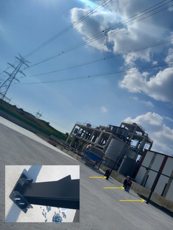

There is a truck loading platform supported by iron columns x4 on each side. The platform will have a FRP roof as well. The whole platform is under high KV cables that are passing above it & we are having static electricity problem at the top section of each column (yellow arrow)
The loading platform will not have any flammable material (HCl & NaOH liquid only).
Any recommendations for mitigation this? If users here require more input from my side please mention.

Here it is rotated a bit.
LittleInch, I was not falling ...but in a single picture I want to capture everything so I took a panorama photo.

The "static" voltage problem depends on the line voltage, not the load. The voltage is actually induced in the person touching the not the steel itself, which is connected to earth through the column footings. It may be mitigated by changing the roof from FRP to a steel roof that is connected to the steel columns. The steel roof would shield people from induced voltage.
We investigated a similar problem in a 230 kV switchyard. Workers would get a shock when touching circuit breaker cabinets. The cabinets were properly grounded. We could measure several volts between a piece of metal held up in the air and the breaker cabinet. Putting a piece of steel plate above the cabinet, connected to the cabinet provided enough shielding to reduce the voltage significantly.

As jghrist pointed out, the voltage is induced in the person.
There is a voltage gradient through the air from the overhead line to ground.
A person who is not grounded and is between the line and ground becomes a common electrode of two capacitors in series.
The line to the person is one capacitor and the person to ground forms the other capacitor.
If the person touches a grounded object. he will discharge the capacitor formed by his body and ground.
The higher in the air and the closer, on a PU basis, to the high voltage line, the higher will be the voltage of the charge on your body.
The solution is to either stay off the roof, or to make the roof conducive.
If you must touch grounded objects, touch them first with a key or a wrench, and maintain contact until you get a bare hand on the grounded part.
The charge is roughly related to the fraction of the distance to the high voltage line.
If you are 5% of the distance from ground to the line you will have more of a charge than if you are 3% of the distance.

A person or conductive object on the roof will become a capacitor plate and charge to the voltage at that point in the gradient.
If the person touches a grounded surface, the charge stored on their body will discharge.
The actual charge will be very little but the voltage will be high enough to cause a spark and an uncomfortable shock.
