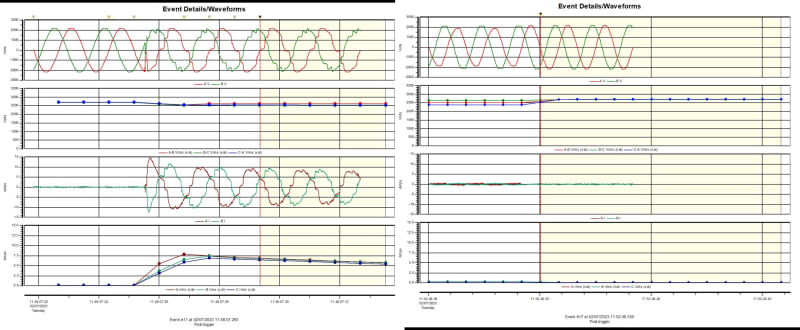

I tried to measure the current and voltage of an induction motor driven by a VSD. The measurement was taken at the input of the VSD, and the results are as follows:
Voltage:
Current:
The waveforms are heavily distorted, especially the current waveform. Is this normal? Could it be caused by harmonic distortion? Note that the voltage waveform also appears distorted even when the motor is not running.
Thanks,
Angga
You appear to be looking at the source side of a six pulse rectifier. That's what many VFDs use.
All inverters will have some amount of distortion on both the input and output sides. How much is dependent on how the electrical current/voltage is filtered. Some of the distortion results from the switching action within the inverter, and some is a result of the impedance mismatch between source (inverter) and bus (for input side) and/or load (for output side). There is no definitive tie between the input harmonic content and the output harmonic content that applies across the board.
As to why there might be input harmonics on the voltage waveform when the motor is not turning - it depends on the drive setting. Is it truly OFF - or are you set to ZERO SPEED? For example, at zero speed, the current is fluctuating to hold the rotor in position.

The current waveform looks typical for a VSD. Very high levels of distortion are typical for current waveforms.
The trapezoidal voltage waveform looks quite strange since voltage distortion values are usually fairly small. Is the supply coming from a utility source?
The voltage waveform could be distorted if there are other polluting VFDs or soft-starters in your supply.

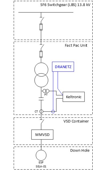

Thank you all for your input. To give more context, here is the measurement diagram. DRANETZ is the power quality analyzer:
In response to your questions:
Yes, the distorted voltage is not when the VSD is truly off, but when the motor is set at zero speed. Please see below the voltage waveform at the moment when the VSD switch is turned on:
The supply is not from the big power grid, but we have an isolated power grid consisting of around 12 GTGs.

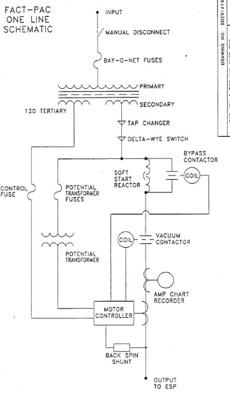

Yes, it does have a soft starter, but it is not shown on the drawing above. The transformer schematic is like this:
Could you please explain how exactly the soft starter distorts the voltage waveform?
Ultimately it distorts the voltage by distorting the current. Your weak supply doesn’t help matters much.

Wait, you have a reactor type soft start ahead of the VFD? Why? Is that left over from an older controller? If so, I would remove it. It does no good for the input of a VFD and will only introduce problems.
The “camel hump” current distortion waveform is absolutely classic for a 6 pulse VFD, or any other non-linear diode bridge rectifier based power device. The flat topping of your voltage waveform is indicative of a weak power source feeding a non-linear load. The diode bridge charges the DC bus by drawing current only at the peaks of each sine wave. After the initial power up sequence in which there is a current limiting system to pre-charge the DC bus softly, the capacitors on the bus will attempt to pull power from the source at the available fault current. In a locally generated system, that can affect the AVR to cause flat topping of the voltage waveform. A line reactor ahead of the VFD is one way to help mitigate this effect because it slows the rise time of the current pulses going into the bus. You also likely do not have a DC bus choke on that drive either, that would help too. Both in concert is the best.

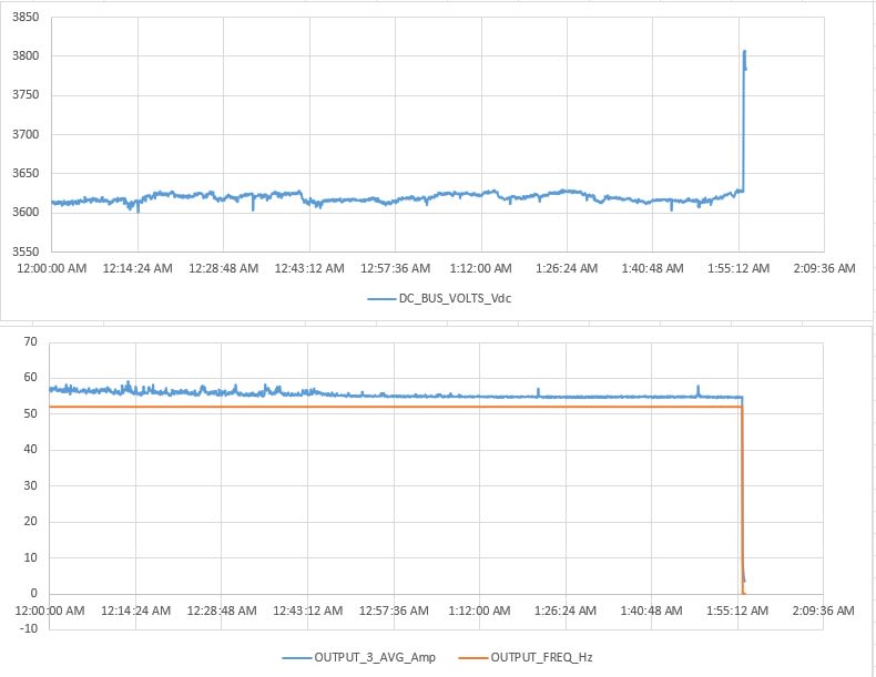

Thank you all for your responses. Here is the event record of the recent IGBT Over Temp trip that was recorded by the VSD:
The VSD was able to record some parameters with a sampling time of 5 minutes. Below is the trend prior to the IGBT over-temp trip. The trend for the events is quite similar. From the trend, it seems like the voltage was constant (referring to the DC bus voltage):
The load is an ESP oil pump, which I think can be considered a variable load. The motor's FLA is 82 A at 60 Hz. The control is an enhanced V/f closed-loop control. The VSD rating is 440 kVA (3 PH, 1400-2500 V, 105 A).
The soft start reactor is the old control, VSD unit was added later

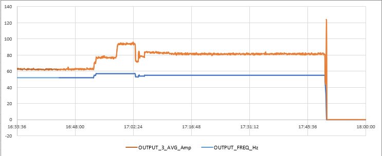

The speed was kept at 52/53 Hz because the motor current rose up to 90 A when we tried to increase the frequency to 60 Hz

Both trip records was at about same time... may be something related with this that interfere with cooling?
VSD current is much below nominal so temp trip reason may be excesive ambient temp, insufficient cooling, too high VSD switching frequency, IGBT snubbers damage or important harmonics in IGBT - motor circuit.
These tripping arised suddenly or more and more frequently?
What length is VSD-motor cable and what is VSD switching frequency set?
After the two previously mentioned trip events, there was another trip event due to IGBT over temperature.
This VSD unit was installed only at the end of last year and has never been run for a long time. The problems varied. Initially, there was a high running ampere as previously described ("the speed was kept at 52/53 Hz because the motor current rose up to 90 A when we tried to increase the frequency to 60 Hz"), and lastly, the problem was the repetitive IGBT hot temperature issue.
The problem of high motor current even though the frequency has not reached 60 Hz has not been resolved yet.
