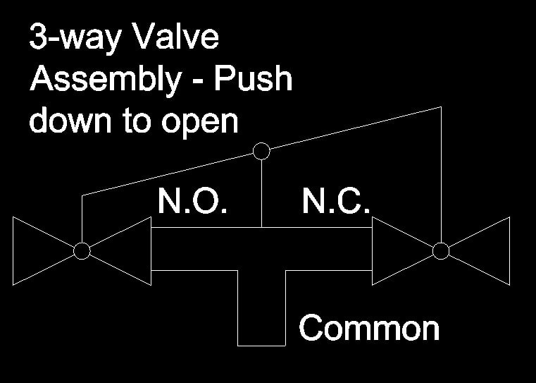

I need to create a diagram of a particular fluid flow system (for a full documented report). I've settled on P&ID as the methodology of choice for the diagram.
One part of the system is proving difficult to represent: a sort of "3-way valve" that is actually a pair of 2-way gate valves, a tee, some pipe connecting the tee with the two valves, and a lever that operates both valves at once. If one pulls down the lever handle, the right valve opens and the left valve closes. Here's a rough visual representation:
Code:
    fixed pivot
   +-----O-----+------- ← lever
  =X====>×<====X=
 valve  tee  valve
Should I represent it as a 3-way valve, or is there some way to indicate in P&ID that a pair of 2-way valves are... "inversely coupled", perhaps is the term?
Label them NO and NC - normally open, normally closed. Same type of logic on labeling valves and switches that can change state based on external controls.
