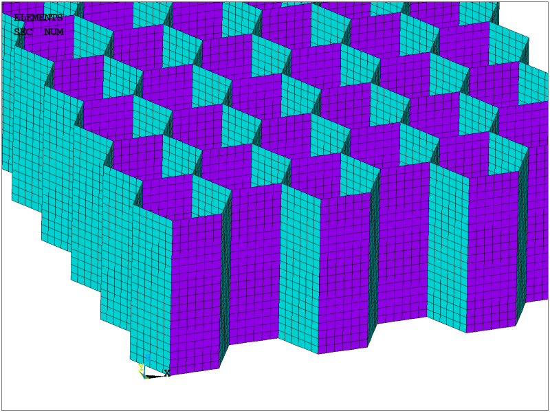

Hello everyone,
I am modeling a structure with shell elements in mechanical APDL. My problem is that the solution stops due to excessive element distortion in very low displacements thus giving unwanted results. Elements on the edges show this problem but not on the inside.
I cannot find a way to overcome this problem.
At the top, I have created a rigid region; at the bottom, it is constrained at all translational degrees of freedom. Displacement control implemented at a MasterNode
Here is a photo of the model.
Can you share a picture showing just the mesh ? Maybe from different sides if it's complex.
Is this good ?
Yes, it seems that the mesh itself doesn't cause this problem. Are those distorted elements located anywhere near the rigid region or boundary condition ? If you want to simulate crushing of this honeycomb, doing it with the help of rigid surfaces might be a good idea.
No all of the elements appear to be approximately in the middle of the height(where the red areas are) and I want to simulate the shear deformation of the core.
those displacement patterns look suspiciously like shear buckles ?

Have you tried to model a flat sheet with shear buckling ?
Yes, indeed shear buckles.

I would take a closer look at the (scaled and unscaled) deformed shape of the model, especially at the locations of those distorted elements. Perhaps the material stiffness is too low by a mistake.
So the red areas in your first picture are the ones with high distortion? If so, then that is exactly expected for this loading. The cell walls buckle in shear. Are you running geometric nonlinear analysis?
have you tried modelling a test case ... a flat sheet, maybe with edge stiffners ... something you know the answer to so you can confirm ANSYS is correct (or that your modelling is correct).
what's your element size ?

When I read your posts I noticed someting that I find a bit confusing. In the first post you say the the distorted elements are at the edges, in a later post you say that they are at the center (middle of height). Are the problems near or far away from the boundary conditions? Because rigid zones can cause issues with convergence.
One option can be to "soften" the rigidity and see if that helps the solution. One way to do that can be to use springs in the supports.
