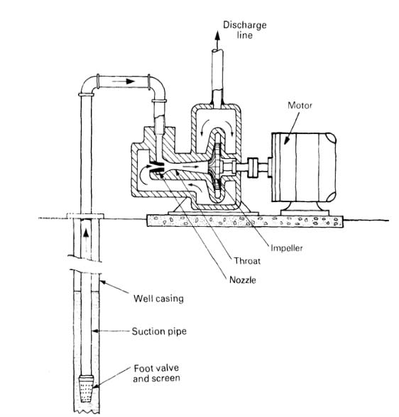

Artisi, Far from me to question your knowledge of these, but they seem to be some sort of hybrid pump,where there is only one source of water in and one out.
Hence the impellor performs two purposes - recirculation through the ejector and also flow out of the discharge at a reasonable head. See the picture below from Pierres links. A more "traditional" jet pump uses a separate pump and water flow as you describe. The jet pumps mentioned so far though does need to be water filled or at least 40-50% in order to start generating recirculating flow through the inbuilt ejector and start "sucking" air and water in to prime the unit until gradually more water comes in and the pump starts flowing water or liquid from wherever it is picking it up from.
But in this case where it seems flow out at a reasonable head (Harltey mentions a head of 48m on the discharge)the efficiency is power in versus flow and head out.
No idea how much flow goes around through the ejector but maybe 50%?
Hence the impellor is essentially fed by higher pressure water coming out of the ejector so NPSH doesn't really come into it. I suspect whoever you are talking to in the vendor doesn't really understand themselves....
At least that's my may of looking at it.
Ok, thanks for your response LittleInch. That makes perfect sense. So would you say if cavitation was to occur it would be where the lower and higher velocity fluids combine just after the jet nozzle?
I think so yes. Somewhere in the ejector is the lowest pressure.
