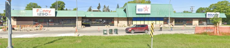

When I first started engineering, Architects and Engineers could do the same work. I've done many buildings, including high rise apartments where an architect was not involved... the ugly 5 or 6 storey apartment down the street is an example. I told the developer that he should retain an architect... my aesthetics are terrible, and one of my first buildings. I feel comfortable with that, but the rules have since changed.
This was another one I did about 50 years back...

@dik
that is god awfully ugly. but still standing!
It is not significantly uglier than a lot of 1970s strip mall types of construction I've seen!
