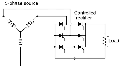

We have a SCR/Thyristor heating system with a configuration shown in the attachment. The device is a phase angle controlled resistive Silicon Carbide heating controller
We are seeing possible signs of line notching being caused by the controller - is this possible? I thought that line notching would only be caused by converters producing smooth DC - I do not see how the converter per the figure shown could cause a phase to phase short i.e. leading to line notching...

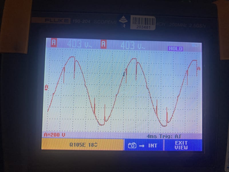

Update on this guys, I checked the system out with a scope meter and I have attached an example of the rather alarming waveforms which were present.
The measurement was phase to phase on a sub circuit which is fed from the main board in the facility - not on the actual SCR controller feeder - hence what you are seeing here is the voltage at the main switchboard i.e. right on the transformer secondary - hence this voltage is seen by the rest of the facility.
At this point I am lost as to the cause. My best ideas:
1) the load is resistive, so even though there's high DV/DT when the thyristor turns on, I wouldn't expect any inrush - unless there are significant parasitic capacitances or inductances at play which are interacting with the fast DV/DT and causing a current surge which is pulling the voltage down. There's potential for some parasitic capacitances in the load but nothing dramatic. It's worth noting that this is not a stiff source and there isn't much inductive reactance upstream of the SCR controller.
2) the load is heating elements with about 0.6 ohm resistance per phase at the furnace operating temperature (for new elements) and the RMS current draw is in line with this - but the condition shown is not a function of the element heat up etc as it occurs at steady state.

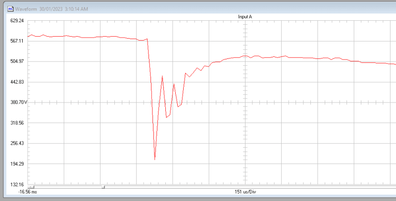

See below close up of one of the 'notches'
FacEngrPE - Sure, but that's not the configuration the OP posted a diagram of, and in his diagram the SCRs can't cause phase to phase shorts. I just looked at it again and it looks wrong though.
123MB - You initial diagram shows the SCRs connected to U from two of the heater loads. That doesn't look right. The SCRs should be at the same end of each load going around the delta. In other words, between U and W and the SCRs should be connected at the W end. Check the configuration and see if that diagram is correct or is not representative of your system.
My mistake, If the wiring diagram is correct, the lowest possible resistance should be the heater, not the kind of low resistance that would cause that large of a notch.
Thank LionelHutz, you're right. It was a stock pic that I just stole from Google Images :) I have corrected.
The transient voltage could be triggered by the sudden increase in current flowing through inductance and stray capacitance. It appears to be a damped high frequency ringing.
Thanks jghrist. I am starting to think it's mostly about the source not being very stiff, having a relatively high secondary impedance and the very high di/dt at thyristor turn on is causing the voltage dip of the source. Perhaps there's also some capacitance and the like interacting with it. I do not have the numbers with me at the moment to calculate a potential notch depth assuming inductive voltage drop is the cause.
