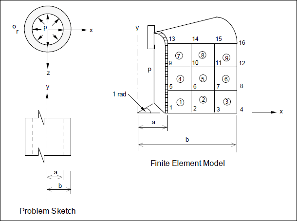

Plane strain elements are two-dimensional elements with membrane only stiffness and in-plane loading. The plane strain element idealization has zero strain in the thickness direction. These elements represent structures that are very thick relative to their lateral dimensions. If you are modelling a cylincrical vessel please consider the simplification option of axisymmetric analysis, ie, body of revolution 2-D plane elements where the stiffness, mass and loads are based on a per radian section basis. You mesh the cross section with 2-D solid plane elements and you are considering 1 radian:

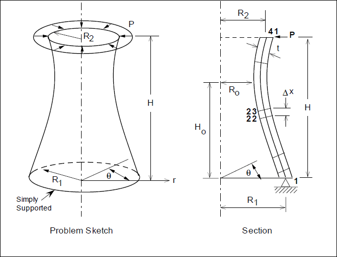

Also is possible to study axisymmetric problems with 1-D Shell line elements in cases where the thickness is very small:
