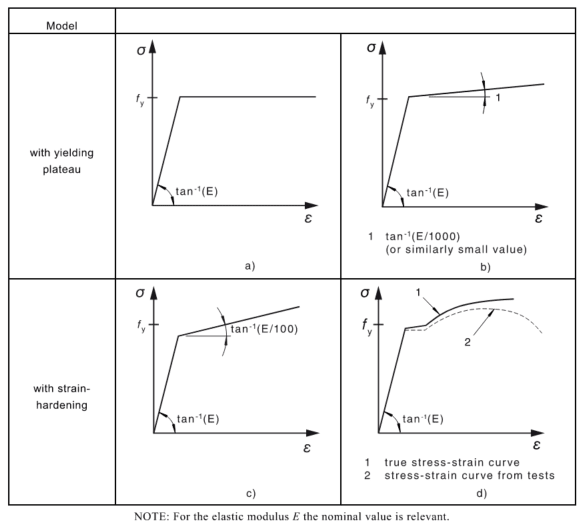

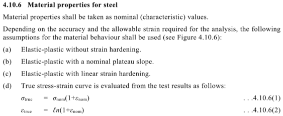

The relevant standard I'm working to is AS 5100.6 (Australian standard for bridge design (steel)), which suggests the following:
The elastic-perfectly plastic assumption is sort of implied in a lot of the analysis we already do, e.g., in determining the plastic section capacity of a beam. But I have heard in the past that it can lead to convergence issues (never had a problem personally though).

I'm surprised that the code doesn't allow Ramberg-Osgood parameterisation. Ramberg-Osgood is a well practiced elasto-plastic material curve, with parameters derived for aerospace materials. If developed for new material would be similar to stress-strain curve from tests (option c might be close) ... the big question is how much testing?
bugbus said:
You both touched on the elastic-perfectly plastic material property potentially not being appropriate for this kind of analysis. Could you elaborate on that a bit further?
No. This is not implied in my response.We still use elastic perfect plastic model for structural as well as pressurised component. That is why I wrote I would argue about EPP model. Rather structural/energy industry standards recommend to use this model as AS5001.6 suggested.
The EPP model capacities would be conservative and less than EP model but close. Convergence issues are not much of concern as you rightly said.
