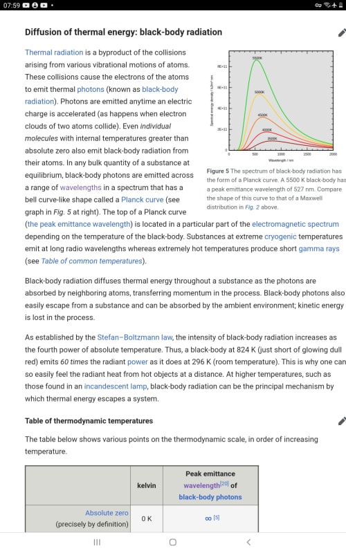

Light bulb temperatures
25W = 75F
40W = 115F
150W= 250F
Spectrum analysis
