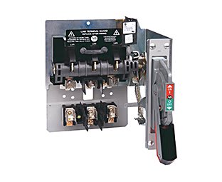

Because UL98 disconnects are usually fused, side mounted versions become a challenge for locating the fuses in a way that permits easy access, as well as being able to interlock with the enclosure door AND allow the disconnect to be capable of being engaged with the door open, without the need for a tool (this is a requirement of NFPA79). The best way to do it is to use what's called a "flange mount disconnect", but that requires an enclosure that has a wide flange on one side, typically pre-punched with the mounting arrangement for a particular brand of disconnect switch.
This is one style;

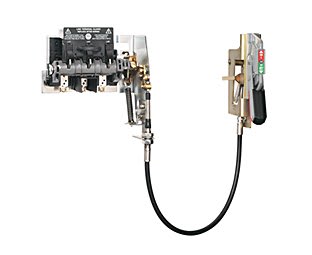

I personally prefer the ones that use a flexible cable operating mechanism, because it gives the freedom to mount the disconnect5 mechanism without worrying about proper lineup;

No absolutely you need a tool to unlock the door if the handle is in the On position, it’s part of the UL98 requirements for any style of disconnect.
In addition, NFPA-79 Standard for Industrial Controls requires that when the door is open, the disconnect must have a way to operate the mechanism WITHOUT a tool. The flange mount disconnects satisfy that inherently, the through-door type must have a special added interior handle mechanism to meet this requirement, often sold as an “NFPA-79 accessory handle” that you pay extra for.
