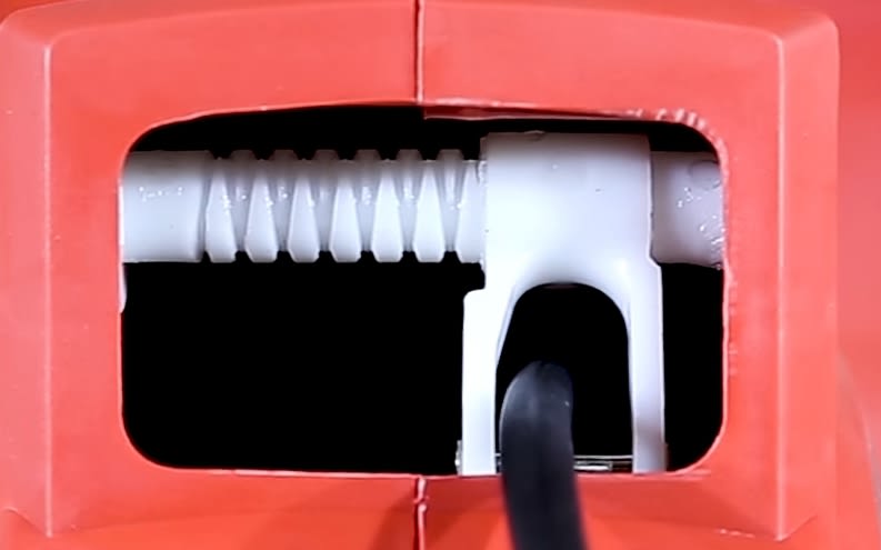

I want to 3d print this threaded rod with a screw, but it is not clear to me what is inside the "screw"?
How this cable allingment mechanism work.
Thanks!
I think you'll find what's inside the nut is more interesting. It looks as though they may have a flexible element in there which kicks over at the end of travel and then follows the reverse thread back to the start.
Just guessing.
Cheers
Greg Locock
Thank you 3DDave!
That is the solution and thank you for the quick answer!
