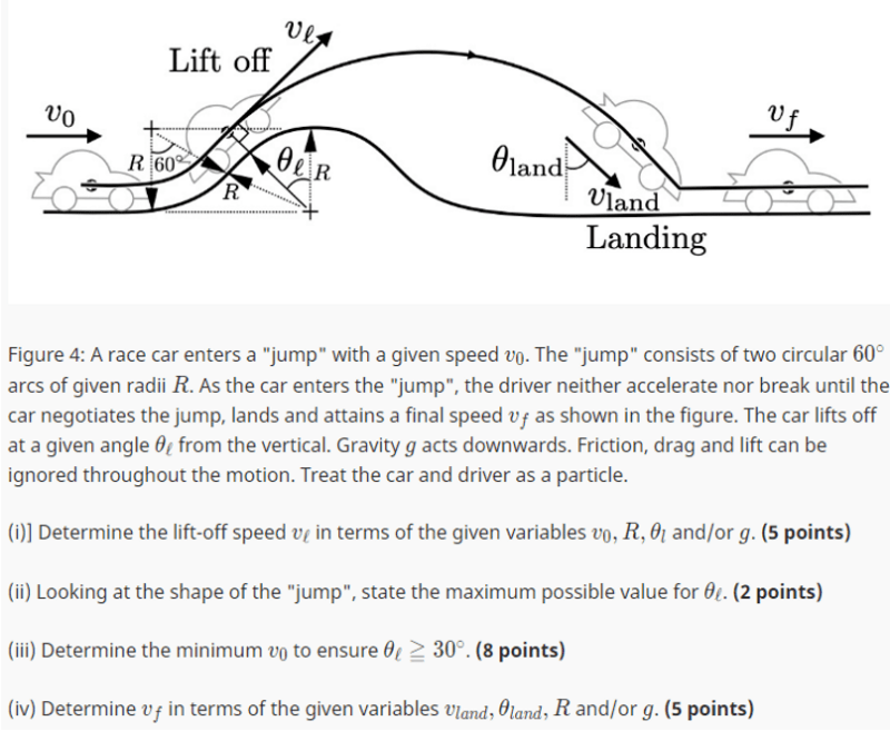

Hello,
Would someone be able to help with this question?
Any help will be much appreciated. Thank you :)
Show us your working so far. We do not do your homework for you. It would probably be a good idea to tell us what you have recently studied in the course that set this problem, as there are several approaches. As a clue (i) is the hardest part in my opinion, and (iv) is trivial.

Yes, I'd guess no bouncing. It doesn't say but I'm assuming there is no tractive force either.
So, some intermediate questions
Do you need to know what is going on in the first arc?
What is the vehicle's velocity when theta = 60 degrees?
What needs to happen for the vehicle to take off? or if you prefer, remain in contact?
The reason I asked about what you were supposed to have learned that this is testing you on is that it is solvable with high school maths, but is an absolute bear to get a complete trajectory (which is more than the question asks for), I think. Whereas someone who is happy with integrating along a line or is studying lagrangians would do it quite differently.

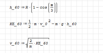

@delast, assuming no traction force, the speed at the intersection of the two arcs will be less than it was initially due to gain in PE (and so on and so forth as it climbs the second arc). You can try a force based approach for this bit, but it would involve solving an integral, energy methods are less hassle.
