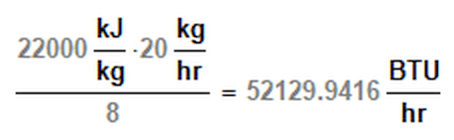

Your supposed gas consumption works out to 52 kBTU/hr per burner, which is the capacity of a small burner on a stove. The large burners on a stove are typically around 120 kBTU/hr, so that's a possible issue.
However, you've not indicated whether the bread is underbaked or what. Also, have you proven your bread recipe in a regular oven; I would assume so, but assumptions are not always correct

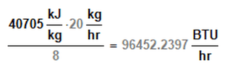

Are you sure?
I get about 310 kW of heat burning 20 kg of gas per hour.
That sounds a lot, but maybe not for an oven expecting to bake 20 loaves a minute.

Are you sure?
Not 100%. I used the value in and divided by 8 for the number of burners
TTFN (ta ta for now)
In engineering toolbox you need to click on the little blue symbol to get the second set of units which then gives you 45,000 KJ/kg. Still a bit low in my opinion ( I was effectively using 57,000 HHV). The methane figure is 55,000 in eng toolbox
So your calc even using the lower version is then 112,000 BTU / burner or 32 kW per burner.
@LI, thanks, I should have checked more carefully. At the higher value, it seems more plausible and consistent with conveyor pizza oven on steroids, but I couldn't find anything specific for conveyor bread ovens
