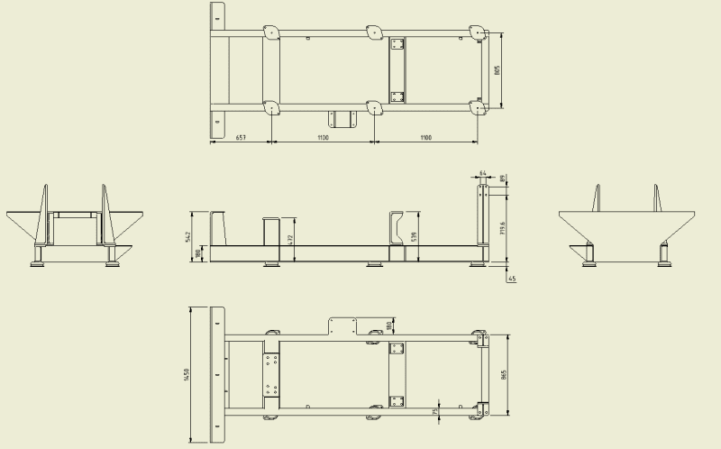

I need to find the optimal placement for antivibration mounts. In order to do that, the reaction forces have to be calculated first.
Here is a FBD of the structure:
What will be the resulting reaction forces at support A?
Each load will produce a reaction on the three supports. This can be found numerous ways, but a moment distribution is probably the most direct way in spreadsheet program. Once you have the reactions for each load, you can superimpose them according to how they occur in time, relative to each other, i.e. sum the reactions from the loads that will occur at the same time. If some loads do not necessarily occur simultaneously, you'll have to look at whether those loads add to the reaction or subtract from it (Hint: F3 will produce a negative reaction at A).
Your beam is indeterminate and therefore cannot be analysed without considering its stiffness. If you don't understand why, try moving B up or down. The force on it would vary from 0 to a lot.
Your table says 4 loads, your diagram says 3.

How are you, or have you been trying to solve this? Since is is a statically indeterminate problem you cannot solve it utilising moment and force equilibrium alone.
Hi VFreshEngineer
I would use the superposition method on this beam problem and remove the centre support. With the centre support removed, it then becomes a statically determinate beam and you calculate the reactions at the two supports but also the slope and deflection of the beam at the position of the middle support. Now at the middle support the slope and deflection should be zero, so now you revisit the beam section putting an unknown force upwards where the middle support would and recalculate the equilibrium so that you have zero deflection at the third support position.
See link below
Hello again,
I see now how this can be confusing. The last load (nr. 4) is due to the weight of the beam itself, so the last force should actually be drawnn as an equally distributed load.
This is a 3D-problem, which I similified to 2D. Perhaps oversimplified? The frame it's not exactly made out of beams. It's made out of bended steel S355.
All of the loads will be present at at times, as they are representing the weight of the components that are mounted to the frame. Does it mean that I can sum all of the reactions to just have one force acting on the structure?
Hi again
It might be better to do this with a FE program package because that frame will have varying stiffness along its length due to its construction and I have no idea how accurate you need to be in terms of positioning the vibration mounts. That said you could calculate the reactions for one side of the frame using the superposition method, assuming the beam is a channel section which I assume from your last post but how accurate it would be is anyone’s guess.
Slope at centre support doesn't have to be zero. Only the deflection to give you sufficient equilibrium/compatibility equation to solve for the 3 unknown vertical reactions.
In a statically determinate system, just having sum of moment about a few locations equaling zero, and sum of the vertical reactions and loads equaling zero is enough. But in a statically indeterminate system you need further equations to be able to solve. Usually this involves looking at deflection compatibility as others have noted. Taking away the centre support and determining what reaction gets you to zero deflection, as easy as that.
You should be able to solve one side channel for 1/2 the total load as per your original post. Apply the loads where they are applied in reality, don't sum them all to one load.

Your structure can be solved by double integration method if you assume it is flexible, and that it is sitting on an infinitely rigid base. This allows you to define boundary conditions that let you solve the statically interminate reactions.
In vibration analysis, your structure is infinitely rigid, and it is sitting on flexible mounts. Your optimal arrangement is for your mounts to be arranged symmetrically about your centre of mass. If your structure is set up symmetrically, each mount sees the same displacement and the same force. If your structure displaces a distance x up or down, each mount will continue to exert equal forces. These will a function of x, and your mounts' spring rate. If your structure rotates about the middle mounts, the fore and aft mounts will deflect in opposite directions, and the forces will vary correspondingly. Vibration is a dynamic condition. All kinds of weird things happen.
