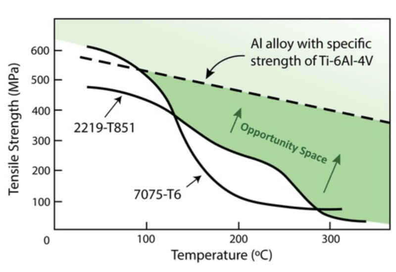

Dec 25, 2022 #1 Uralsk Mechanical Joined Feb 21, 2021 Messages 39 Location ID What kind of aluminium alloy grade that has the highest UTS for temperature up to 300° celsius?

Dec 25, 2022 #3 TugboatEng Marine/Ocean Joined Nov 1, 2015 Messages 12,020 Location US Maybe you should reach out to these guys, they are currently working on the same problem. https://www.tandfonline.com/doi/full/10.1080/09506608.2021.1951580 Upvote 0 Downvote

Dec 28, 2022 #4 MC6 Mechanical Joined May 19, 2022 Messages 20 Location US But why? Latent heat of aluminum is so high as it is, and the conductivity is so high... why would you choose aluminum? You could likely add cooling to your part. Otherwise time to look at titanium. Aluminum isn't a hot working material. Upvote 0 Downvote
