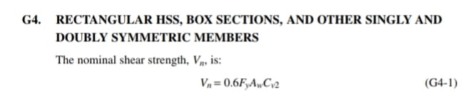

In the 2016 specification, rectangular bars and rounds would be covered under equation G4-1 for singly and doubly symmetric members. Looks essentially the same, just a slight reorganization.
For solid bars, you should probably also consider that peak shear stress is greater than the average shear stress. Although if it's a member in a sap model the proportions are probably such that shear won't be near failure anyway.
I think the 0.6 factor, at least for square/rectangular sections accommodates the 1.5x actual shear stress increase...

it seems that the factor CV2 has no relation to round sections (solid bar) see the following definition
For other singly or doubly symmetric shapes
Aw = area of web or webs, taken as the sum of the overall depth times the web
thickness, dtw, in.2 (mm2)
Cv2 = web shear buckling strength coefficient, as defined in Section G2.2, with
h / tw = h/ t and kv = 5

Shear buckling would be impossible for a round section (or square section, or rectangle bent about its minor axis) so Cv1 or Cv2 would be 1.0.
Based on your latest reply, I believe that equation G4-1 is not the correct equation when designing shear for round bars.
Thanks... I'd always thought it was due to the parabolic distribution vs. uniform distribution.
That's correct because h and t aren't defined for a circular section.

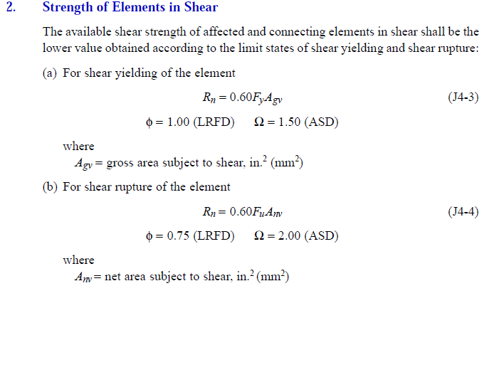

I think there are two practical options:
The first option is to consider "failure" to be at first shear yielding at mid-depth. That's the approach I typed about above.
The second option is to compute the fully plastic shear strength with 0.6Fy over the entire cross-sectional area. With that approach, Aw would be the area of the circle. That's similar to what is done for bolts.
The first option is more conservative. If it results in a reasonable strength ratio, then I'd go with it and move on.

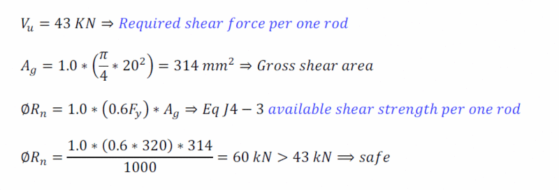

from my point of view I suggest the following equation
its all about the strength reduction factor shall we use 0.9 as per Equation G2-1 & G4-1
or strength reduction factor = 1.0 as per J4-3.
Eq. J4-3 is the second option that I mentioned yesterday, except for the phi factor.
For a connected part (Section J4) use phi = 1.00.
For a member (Chapter G) use phi = 0.9.
You'll have to judge whether your component is more like a connected part or member, and select the phi based on that.

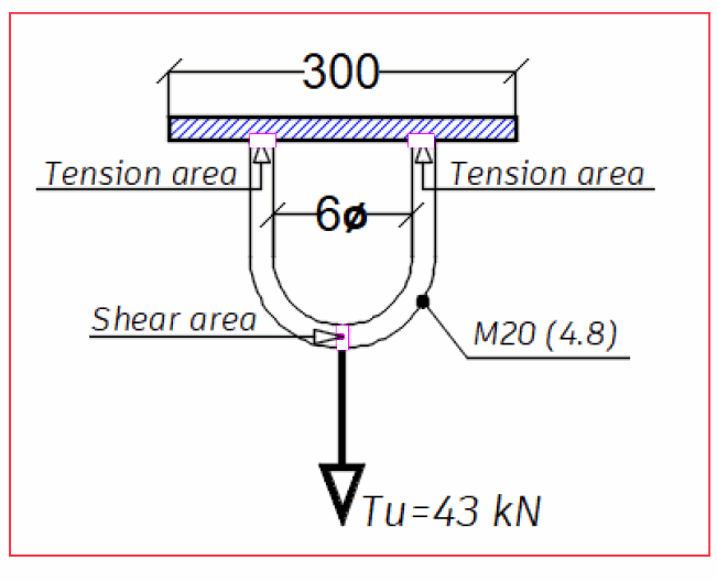

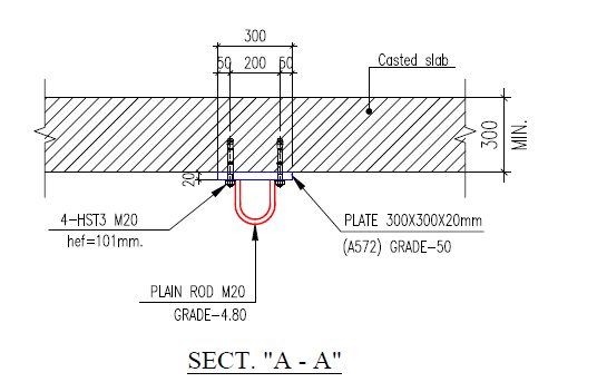

Reference to the following case which represents a chain-block as per the next screenshots
failure will be due to direct shear not tear-out and it seems that the plain rod in this case may be considered as a connected part.
shall i consider the total load = 43kN when calculated the required shear strength or have of it ??
The shear would be 43 kN / 2. Draw an FBD of the left half of the U-shape. Cut the FBD off just to the left of the Tu. The shear equals the tension in the leg.

Dear Ayman
you should Not worry too much about which equation controlling the design (shear or tensile stress)
in fact, you should worry about two things here;
1- the anchoring RAWLBOLTS
since they could easily break-through (mostly made be cheap metals)
so small advice, is to extend the anchoring to penetrate the roof (RC SLAB) so you could use a suitable anchors with enough(guaranteed) axial tensile capacity to prevent any failure due to (sudden impact or bouncing of lifted load ... etc)
2- the welding type around/between the U-shape hook legs and base plate ???
3- the plate metal type ???
