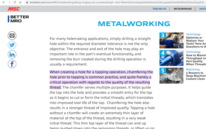

Are you sure about that ? Take a look at this : I feel like the guy in the video is right because if you machine an already tapped hole, then you might have troubles putting a screw afterward. I tried the opposite once, i cut a stud and then tried to put a nut on it but i couldn't because by cutting it i messed up the threads. I guess the same would happen if you chamfer an already tapped hole ?[ponder] I know, the guy in the video completly erased the chamfer zone by using a bigger tap size but i also found this article :
