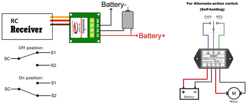

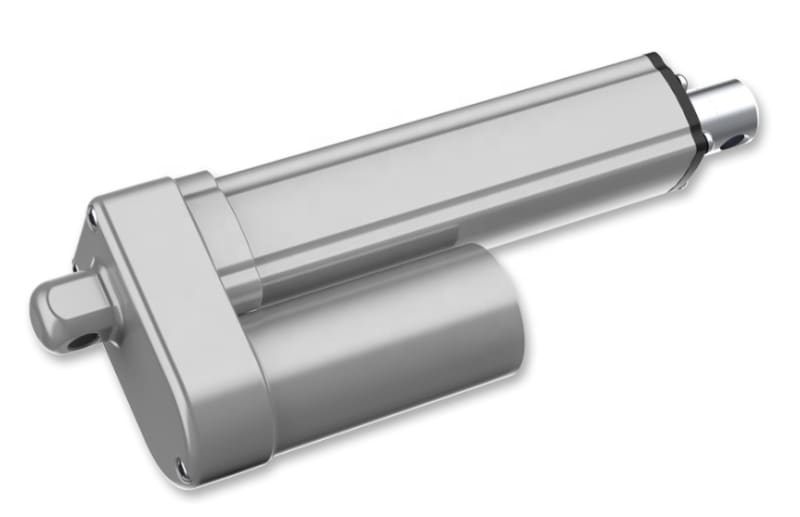

My 24VDC motor is a linear motor like this.
I need to be able to control the clock & counter clockwise motion of this motor so that I can have open and close function of my door.
Could you tell me how to set up this mechanism using battleswitch?
The schematic shown has a wire connecting battery positive to one terminal of the motor and another connecting to the other terminal. The motor will run full speed in whatever direction that implies until it reaches a mechanical stop, and then let the smoke out. No current will flow through the resistor because there's no escape path for it that leads to the other side of the circuit. All the other stuff in the circuit is decoration.
Normally there will be a forward relay and a reverse relay, and limit switches to break the forward control circuit before it hits the forward mechanical limit and break the reverse control circuit before it hits the reverse mechanical limit, and careful thought put into preventing something bad from happening if you try to energise forward and reverse at the same time.
Baaed on the photo I think it is double pole, double throw switch so it just needs end-stop switches. We would know that if you provided the proper information to start with. The description says single pole double throw, so check before buying.

Yes, my linear actuator has built in end stop switches to limit its stroke.

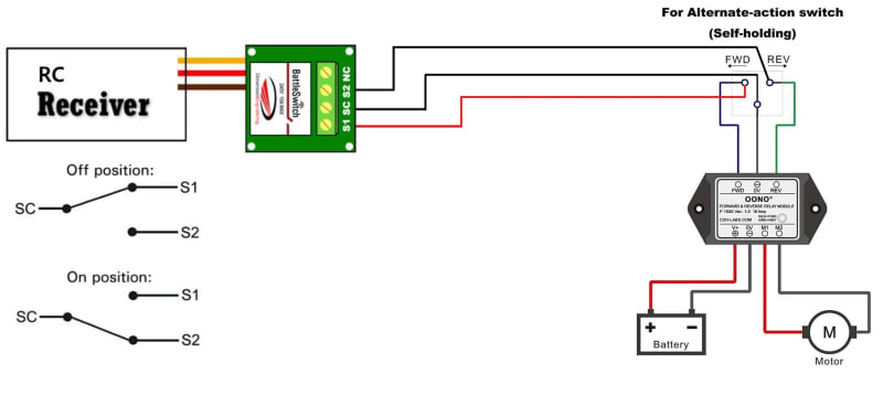

Could you advise me how to use that relay module with battleswitch?
I tried to draw some diagram of connect them by myself but I am really confused on how to connect these two modules together.
I am going to GUESS - purely by the nomenclature of the contacts, that on your illustrated "battleswitch":
"NC" stands for "no connection" - it doesn't do anything and isn't to be connected to anything (why is it there, is another question that I don't have the answer to)
"SC" stands for "switch common". On the diagram on the right, see how the switch shown in the illustration has 3 terminals, the one on the bottom (on the drawing) being a terminal that is "common", i.e. it could be connected to either the terminal on the right for "rev" or the terminal on the left for "fwd"? That's the "common" terminal.
"S1" stands for "switch 1". Left terminal "fwd", or right terminal "rev" (as the case may be), on the diagram on the right.
"S2" stands for "switch 2". Right terminal "rev", or left terminal "fwd" (as the case may be), on the diagram on the right.
I am making a fair number of ASSumptions in writing this post. A multimeter, with your "battleswitch" in hand, will tell the tale whether my ASSumptions are right, or out to lunch.
And by the way, if my ASSumptions are correct (and the nomenclature agrees with the diagram on the left bottom), the schematic at left top will not work. It will operate the motor in one direction (when "S2" is chosen) only. When "S1" is chosen, there is no connection to battery negative (because that's connected to the now-open "S2" terminal), so the circuit as a whole is open.
One more thing. In order for this to function correctly, the "battleswitch" must have a "neutral" position in which neither S1 nor S2 are connected. Otherwise, your motor will always be driven one way or the other ... no way to stop it without pulling the plug.
Hi Brian
Thank you so much.
ok, I will test it by making connections like this.
