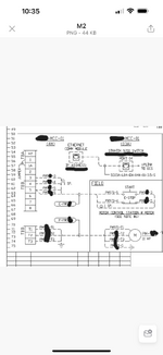

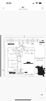

The schematic above has to be automated. What would be the best two options to put a START relay in the Bucket for pump remote start .Mind you, this pump already has a low level cut off so what’s needed is just to start it remotely. The idea is to put a start relay and wire it to a DCS DO Charm and configure it to start based on Level

From an industrial control background:
I would use a level control relay and wire it according to the instructions that come with it.
I would use DCS to monitor and report.
If DCS control was desired, I would leave the primary control with the level relay and use DCS NO and NC contacts in parallel or series with the level control rely contacts.
In the level range between start level and stop level, the pump may either be running or stopped depending on the recent operating history.

Great insight. What about putting an interposing Relay in the START circuit . The primary function will be to close the circuit and start the pump and have the NO contacts wired to the DCS DO contacts and configure it to start/ stop pump based on Level with an already existing Level Transmitter. Let me know your thoughts
Are you familiar wit the basic three wire motor control circuit?
Start with a basic three wire motor control circuit.
Add low level contacts in series with the stop button.
Add high level contacts in series with the start button.
If the level signals must come from the DCS, functionally the DCS contacts may be used directly or you may use an interposing relay(s).

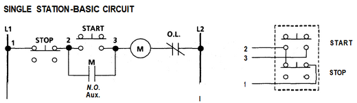

See if you can download the diagram and then edit it.
You start by making additions and posting them.
Screenshot 2025-05-27 at 19-47-08 800-2.0 Typical Wiring Diagrams for Push Button Control Stat...png

2nd assignment. Edit the digram to insert a set of low level contacts in the proper place.
LOL..I completely understand your point and I do have the history of the actual running conditions. This motor was designed with no remote start, just a low Level cut off. I am considering ways to add a remote start to the schematic. I looked at ways to program this via DCS but it hasn’t worked quite well and I’m still looking into that option via Modbus .hence the option of using an interposing relay to start it based on Level and the existing low level stop will complement it.I am looking at wiring the Relay across the Start bottom and in Parallel , that way I can use the physical start bottom and DCS remote start as well. I have a Radar LT and Pump is started in the field but will trip at a certain Low Level. Trying to go with the best option for remote start. Do you
I don't think that you will be happy with a maintained contact in the start circuit.
You should lose your DCS signal to the motor starter as soon as the DCS loses the signal from the high level switch.
If you use an interposing relay I suggest a timing relay for Rapid-restart protection.
This is not a must.
I have many times done level control without that added protection.
One thing is to wire a momentary switch to M1, that’s the remote start on the control loop. Then no matter if you loose DCS or not ,it will keep running.Until you tell it to stop or hit the low level
