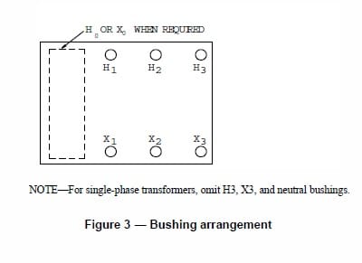

We have 3 phase 26.4kV Delta - 490 volt Delta and 490 volt Wye, 3 winding transformer which feed 12 pulse rectifier on 490 volt side, generating about 3 MW for Traction service. This oil filled transformer has nameplate but no markings at 26.4kV bushings for H1, H2 and H3. Similarly on secondary R1, R3 and R5 are Delta and R2, R4 and R6 are Wye bushings with no markings. My main concern is to find H1 bushing on primary.
1. Assuming I stand on 490 Volt bushings facing 26.4 kV bushings, which side is H1 bushing....on right hand side or left ?
Thanks in advance.

Left side- Please see C57.12.10 Standard
That's not how I read C57.12.10 Fig 3. If you are looking at the transformer from the high side, H1 is on the right. Assuming that the transformer is built per C57.12.10. C57.12.10 doesn't sllow for secondary bushings named R1, R2, R3, R4, R5, R6. The nameplate also shows it that way.

Thank you JGHRIST.
It seems that Fig 3 -Bushing arrangement, matches with what PRC wrote (Left side is H1 bushing, if you are on secondary bushings looking at high side bushings.) It seems that ANSI 57.12.10 may be defining it in a different way, but Fig 3 is very clear for H1 position. You have a point that R1....R6 are not per Std.
This transformer is Rectifier Transformer, and now I am not sure how R1...R6 orientation is, wrt high side. If you see the nameplate dwg, H1 and R1 are shown diagonally opposite. But nameplate may not represent physical layout.

If you want to place LV terminals on the short side of the transformer, Terminals X1,X2, X3 are moved clockwise or anticlockwise. The rating plate is normally placed near the driving handle of the tap-changer. The Rating plate also will have a sketch, similar to fig 3 of C57.12.10
This notation seems different from that of IEC where standing in front of transformer facing HV terminals Left to Right is H1 to H3.

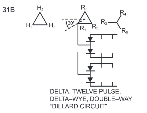

From C57.18.10-2021 IEEE Standard Practices and Requirements for Semiconductor Power Rectifier Transformers
