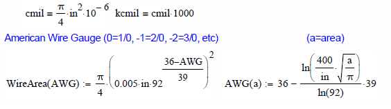

#12 AWG has an area of 6530 cm, not 6530*(in/1000)^2. One circular mil is the area of a wire 1 mil (1 in/1000) in diameter.
I developed the following Mathcad custom units and functions to help keep things straight:
jghrist,
First, thanks for the key to understanding!
Ok, so my variable 'CM' doesn't have a unit of area. 'cm' is basically a new unit that represents how many defined areas (area of square wire with 1 mil edges) are within an area. So it is unitless because it is square area (using actual wire diameter as leg length) divided by defined square area of (in/1000)^2. I also think I had the wrong units of K and with this new definition of the unitless 'cm', I think I have it all resolved. The units of 'K' should actually be Ohm*1000cm/1000ft and the 1000's cancel out to leave you with Ohm*cm/ft and 'cm' is defined as unity, so it further reduces to Ohm/ft.

For posterity, below is what I reduced my calculation to. I realized that 'CM' can be cross-sectional areas of actual wire and 1-mil wire. You don't need to use the square areas of each, or you can... the end result of the ratio will be the same. I understand why they simply use the square areas though since the ratio of circular area over circular area will have the 'pi' and '4' values cancel out and you are left with dwire^2/1-mil^2 (i.e. square area over square area). I cleaned up my comments in the calculation too.
Thanks again jghrist for explaining the CM value.
