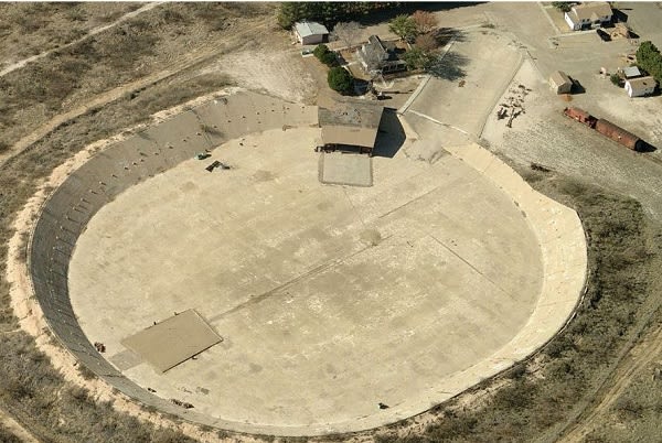

Just don't do it this way....
Apparently it could in theory hold 5 million barrels....
And had a timber roof!

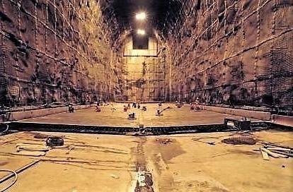

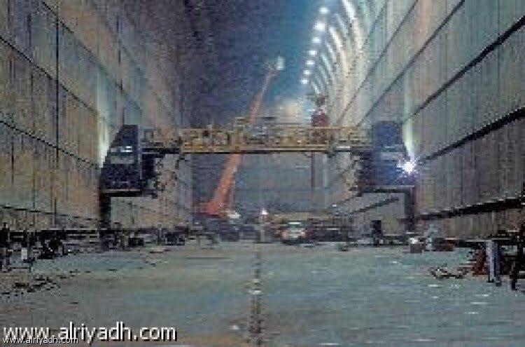

Now if you want a real underground storage tank look to the KSA.
They have caverns in the rock each 400m long, 25m wide and 30m high. All lined with steel. circa 2 million barrels each.
multiple ones each site and 5 sites (though I think only 4 were ever built)
I've been in one and they are gigantic.
5 Were built.
1 Riyadh
3 Buraydah
5 Jeddah
6 Abha
7 Medinah
