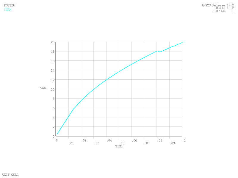

Hello everyone,
I am running a nonlinear analysis with displacement control. The analysis always stops at the same point producing the same graph of force displacement.
does this mean it reaches the limit of the structure?
Material nonlinearities and large displacements are enabled
Displacement controlled loading
elements used shell181 ( Ansys Apdl software)
What approach should I follow to understand what's happening?
Can you say more about the analysis (geometry, mesh, material model, boundary conditions, loads, interactions and so on) ? Can you share the F-u plot ?
Perhaps it reaches buckling/collapse which cause problems for standard N-R solvers. Try with arc-length or dynamic solver.

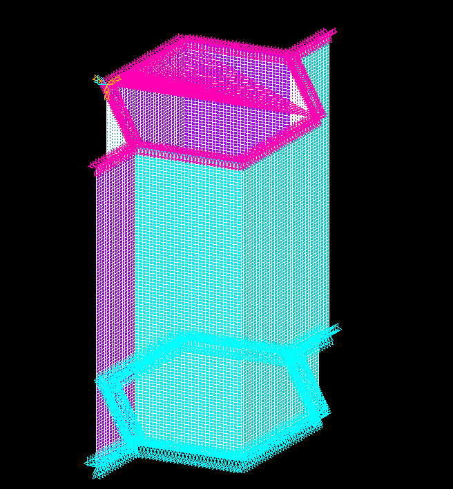

geometry: hexagonal cell dimensions angled walls 3mm horizontal also 3mm
mesh: shell181 with element size 0.1
material model: young modulus 70GPa v=0.33 Non linear properties: Bilinear isotropic hardening using von Mises or Hill plasticity with tangent modulus 0
boundary conditions: restricted at the bottom (UX,UY,UZ =0) top rigid region (cerig command)
load: displacement on a master node at the top
what interaction would you like to give?
These is the F-U plot ( If I increase the displ the solution stops at the same point )
I will try the arc-length method to see if the results are any different
Update: Tried arclen method but the solution keeps collapsing
please show a) picture of the model with loading and bc's, b) picture of the deformed geometry at max load.
have you run a linear buckling analysis?
This is the model with the BC and the loading (the purple,on top)

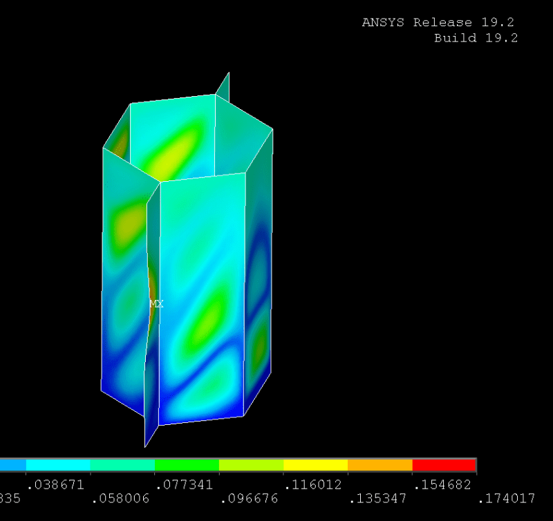

Displacement at max load :

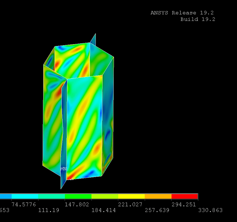

And von miss stress at max load :

so the cell walls appear to be buckled, so no surprise that the loading has reached a maximum. getting the model to run under displacement loading to track the collapse may be difficult.
I would add some imperfections, for example from scaled linear buckling modes.

The standard way to find a collapse load is to run linear buckling analyses and add a scaled mode shape as an imperfection, as FEA way suggested.

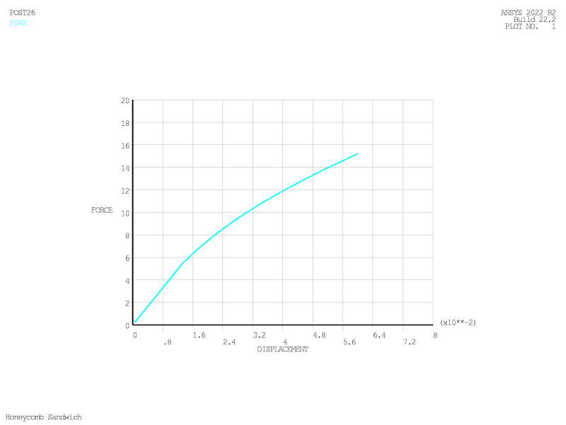

For anyone following this post.
I implemented the recommendations you proposed they worked. The structure seems to have gone further and this is the F v U curve. I don't know how to justify these results.
Thank you for the help you provided!
what do you mean by "justify"? the loading is compression, correct? have you compared the results to that published in the Hexcel core data sheet? (you will need to convert from total area stress in the datasheet to loading on your model section).
also, have you used 2x thickness for the a) the walls with free edges in your model, b) the walls parallel to those free edge walls? core is made with foil ribbons bonded together so those "nodes" are 2x foil thickness.
SWComposites
No, it's shear load. I haven't compared to data sheets. Will this give some sort of validation?
Also, haven't modeled the 2t thick of the walls.

I'd be interested in knowing what changed at F=6. That's the limit of linearity, so there must be a hinge or local skin buckling, forming somewhere. Again at F=18. Break out the cartridge paper and hot glue gun.
