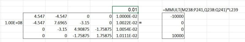

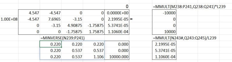

As stated by others, the force at the first node is not zero, it is -10,000 N. The reaction force is every bit as much an external force as the applied force at the other end. If you multiply out the matrix equation with the given displacements it gives the correct result:
But if you add an equal displacement to all the nodes, the forces remain unchanged:
That is why the 4x4 matrix can't be solved, there are infinitely many valid solutions.
Fortunately we know the deflection of node 1 is zero, so we can remove the top row and left hand column, and solve the remaining 3x3 matrix, to find the relative deflection of nodes 2-4.

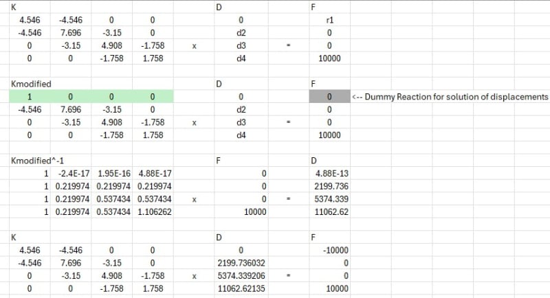

Showing centondollar's method were rather than remove the row and column associated with the restrained degree of freedom instead replace just the row with the identity row and use a fictitious 0 force this allows the whole matrix to be inverted. I have some older textbooks where this method was common rather than partitioning of the stiffness matrix which I believe is the much more common approach these days.
edit: the field labeled dummy reaction should be more clear that it is required to be 0, otherwise the first term in the second row will start to influence the resulting deflections.
