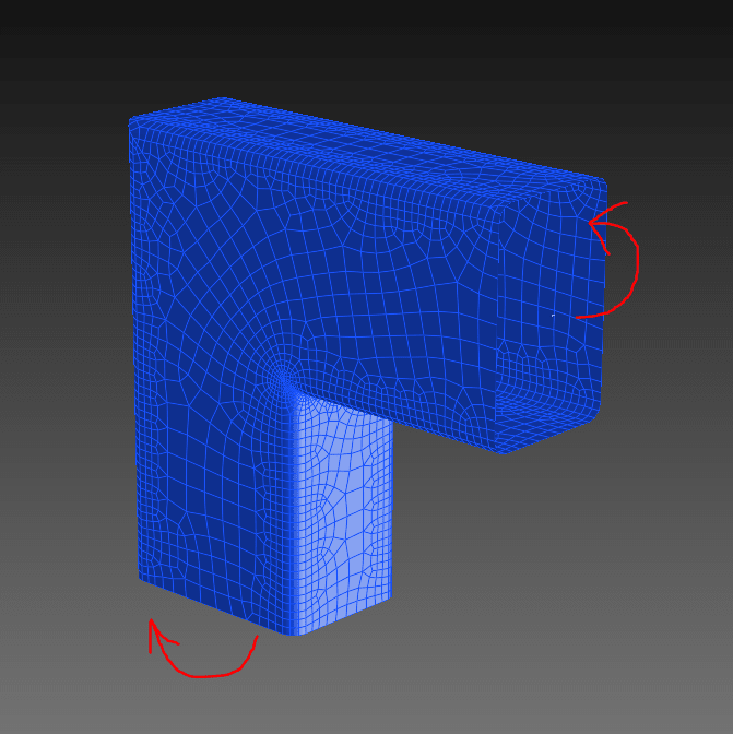

I am trying to model the plastic collapse load for an unstiffened RHS mitre joint using Strand7 (unstiffened in the sense that there is no diagonal end plate welded between the two RHS sections - the two RHSs are simply mitre cut and butt welded together and the joint is hollow all the way through).
I just want to check that my general approach is OK.
The section is a 150x100x5.0 RHS, fy = 450 MPa, fu = 500 MPa. For reference, the plastic section capacity is 52 kNm.
The model consists of 8-node curved plate elements (mostly), although the auto-mesh feature occasionally includes some 6-node triangles here and there. Meshing is more refined around the inside corners where the stress tends to concentrate. The straight portion away from the joint is about 150 mm long, equal to the height of the section. I've used a multi-node link at each end, one with fixed boundary conditions, and the other set to rotate 0.05 degrees about the major axis so that the joint is opening.

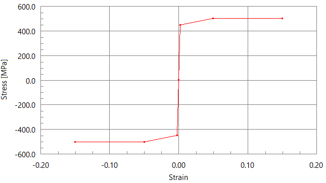

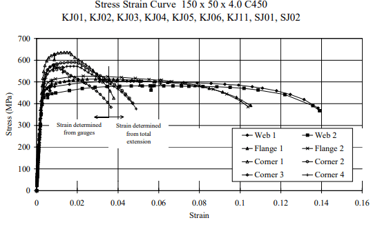

The stress-strain curve is shown below:

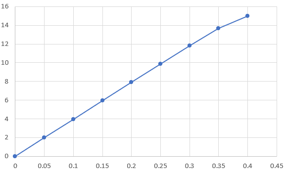

The model runs fine up until the 8th time step (i.e. for an imposed rotation of 8 x 0.05 = 0.40 degrees), at which point it struggles to converge on a solution. My main reference for this type of joint says that the capacity should reach approximately 50% of the section capacity, i.e. 50% x 52 kNm ~ 26 kNm.
However, you can see on the graph below (bending moment [kNm] vs rotation [degrees]) that it doesn't seem to approach any sort of collapse mechanism, there is only a hint of non-linear behaviour as the rotation approaches 0.4 degrees.

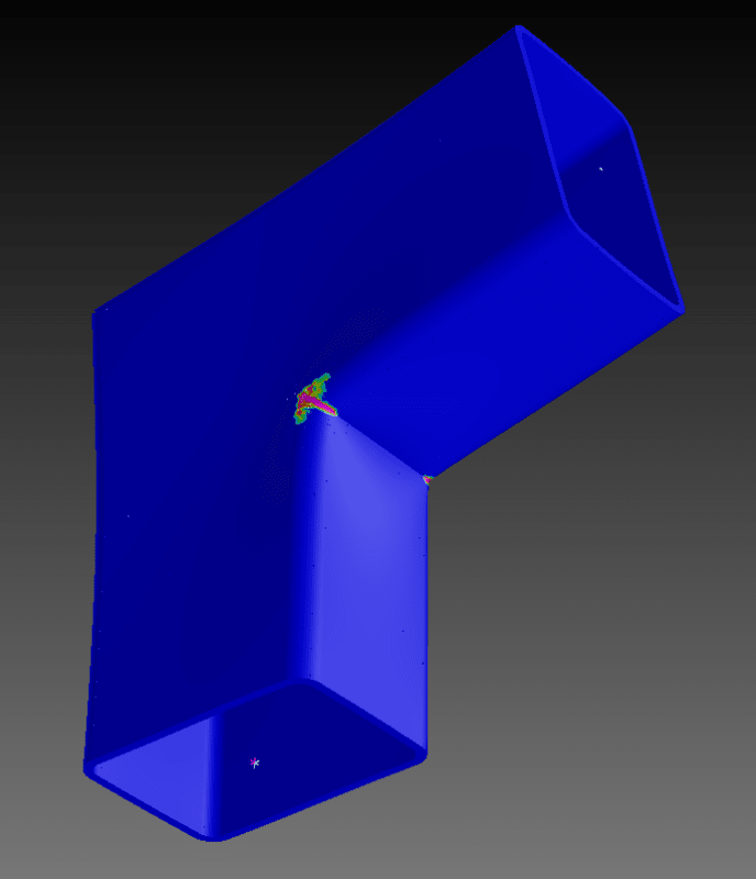

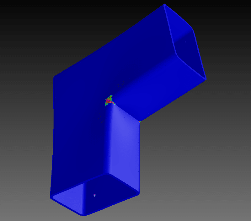

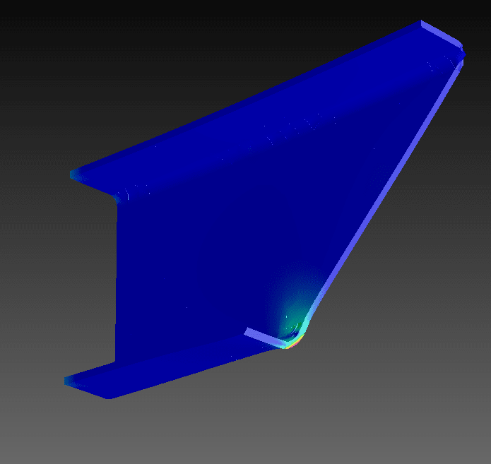

Below is showing the yielded areas at rotations of 0.30, 0.35 and 0.40 (not converged) degrees.
This seems to confirm that the collapse mechanism is not even close to being reached. The yielding is only occurring locally around the corners of the joint.

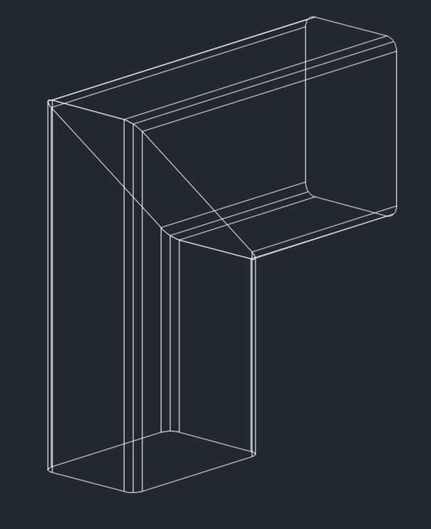

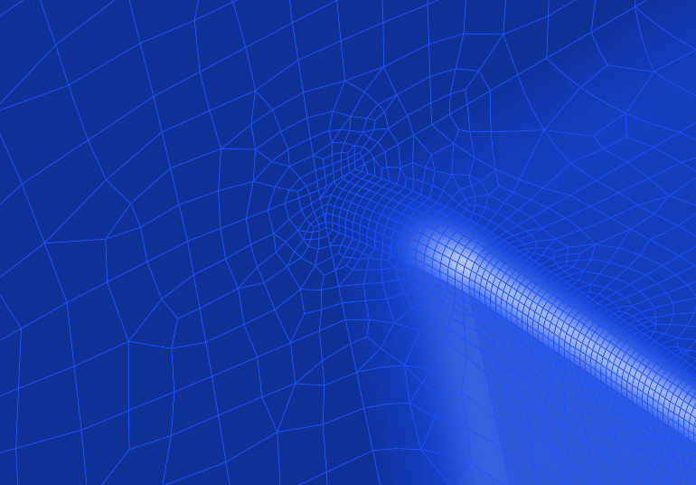

Also, @rb1957 and @SWComposites, the model was generated from a dxf file that I created in Autocad - see below. You can see the sharp corner along the edge where the two sections intersect. In reality, yes, there would be some rounding along this edge where it would be welded.
maybe you should model a radius at the corner that is representative of the weld geometry.
further, how are you accounting for the different properties of the weld material?
Thanks, I'll try that out. Not sure about the second part of your comment, the weld strength used (fu = 490 MPa) would be very similar to the strength of the tube (fu = 500 MPa). I would be tempted to use the same material all the way through unless you can think of a reason not to?
i'm not a weld expert, but the weld material stress-strain response and HAZ material stress-strain response might be different than the base material stress-strain response, which could be important if you are running a nonlinear FEM.

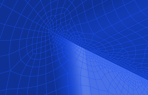

I've figured out how to round the edges, which gives me the below mesh (there are a few oddly shaped elements, but I'm just testing if there's any improvement). So far, it seems to be working, just very slow to converge on a solution. I will run it overnight and see what it gives me.
I am running material and geometry nonlinearity.

How is the material modelling performed? The stress-strain curve you show is not very realistic and seems to be based on some rough zero-hardening idealization found in a code.

@centondolar - I can't answer all your questions, but I'll try. I believe the plates are Kirchoff; I have since removed the geometric nonlinearity as it was slowing down the solver and I don't think it's necessarily relevant in this case; arc-length method; you're correct about the stress-strain curve, this isn't necessarily realistic.
I have since simplified things a bit. I split the model into 1/4 of the previous and included symmetry conditions, removed the geometric nonlinearity, and made the mesh a bit coarser. This seems to get the solver to work in a more reasonable time.

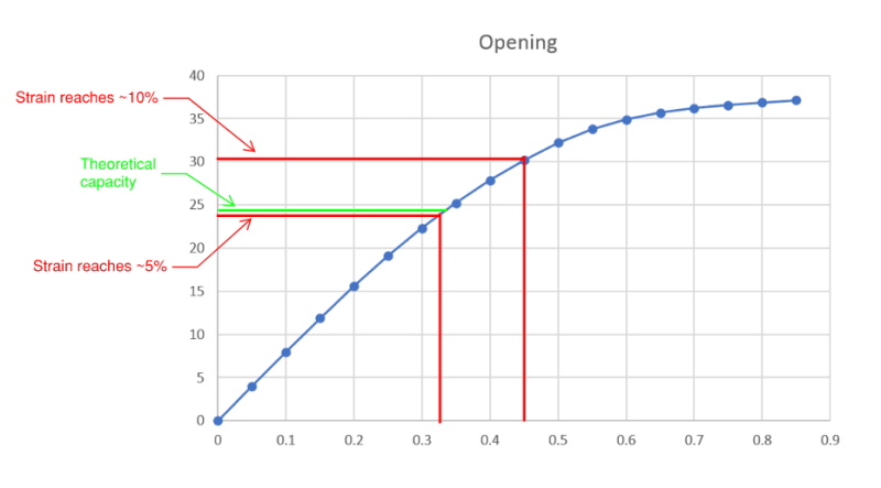

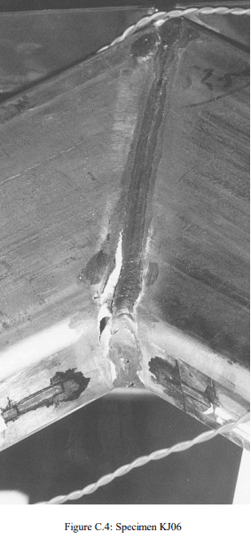

Doing some more reading on the topic (e.g. tests by Wilkinson and Hancock ca. 1998, there's plenty of papers out there), joints of this type tend to fail by tearing of the tube or failure of the weld in the highly stressed corner shown above.
This occurs well before a complete collapse mechanism is able to form. My results tend to show this as well - below you can see that when the strain in the tube starts to exceed about 5%, this is where the theoretical capacity occurs.
Anyway, I think I'm done with this little exercise for now. Thanks for the comments everyone.

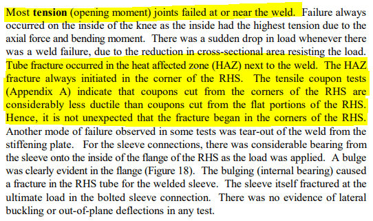

Interesting excerpts from one of the papers I read - 'Tests of knee joints in cold-formed rectangular hollow sections' by Wilkinson and Hancock 1998.
(My highlights added for emphasis)
Fracture at the corner of the RHS occurs at around 5% strain.
