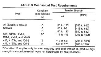

I have not been able to find an ASTM or AMS standard that lists a minimum yield strength for 303 SS. I expected ASTM A582 or AMS 5640 to provide this information similar to ASTM A276 for other 300 series SS. Does anyone know if there is a standard with this information?
I believe that A473 (Forgings) has mechanical properties.
As I recall they are 75/30/35%
But be warned the impact and fatigue properties are not like 304
My brief search only turned up ASTM A581 (Wire and wire rods) with 303 in condition B listed as a tensile strength of 115-145 ksi. (no numbers for yield)
The A581 values are for as-cold-worked material.
The A473 values are for annealed material.
Basically you could treat 303 same as 304 in terms of yield strength. For a spec, it really depends on applications. Besides generic ASTM A276, it seems a few other specs there. For spring-type of application, the tensile of heavily drawn fine wire could not be specified over 180ksi. For medical application strip products, it may have couple of conditions, annealed, slight rolled, heavily rolled....
