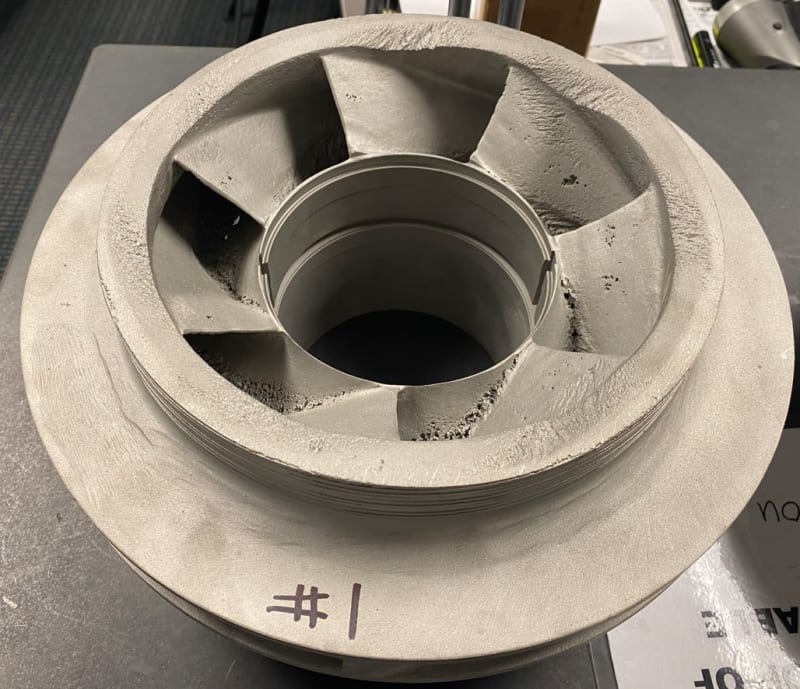

Hello Dear Engineers,
As you may have noticed from my other posts, I am working to study pump components damage mechanism. I found another impeller damage due possible cavitation and wanted to share with you to get your feedback on damage mechanisms. This is suction impeller (first stage) for water injection pump that is used in oil field. Noticed the area where impeller ring sits apart from cavitation damage. What can possibly cause that?
What I see that is unusual is that the cavitation forms behind a vane but stays up on the impeller eye. This says to me that there is insufficient flow velocity through the impeller to carry the bubble down through the flow path. Perhaps this pump is operating too far to the left on its pump curve and is overheating.

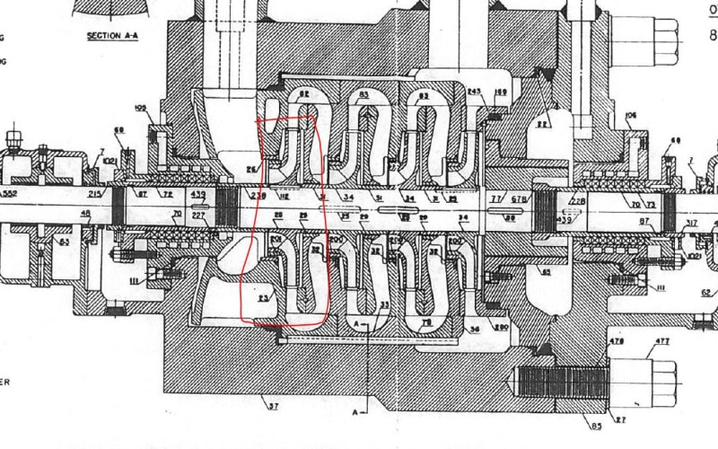

What does this sit into?
Got a sectional drawing of the inlet chamber?
Does the flow then turn 90 degrees and exit from the outside of the impellor?
Bit difficult to tell from only one photo tbh.

The process fluid is jet water and pump is used in decoking process of refinery, where the remains of crude oil from distillation is refined further (coker unit).
Below is the pump sectional highlighted impeller shown in picture.
I can't really see the impellor wear ring surface but it looks heavily scored implying considerable flow perhaps from the outlet side back into the inlet.
Flow into the eye of the impellor looks quite complex.
A lot will depend on how the pump was operated, fluid conditions, temperature, pressure flow etc.
Was it allowed to dead head for long periods?
Suction recirculation cavitation damage.
The pump is pobably running away from its BEP.
The damage along the roots of the vanes looks like cavitation.
The damage to the rim looks like it could be erosion or excessive recirculation (way off of BEP and or end play).
The hole in the mid-vane is a typical casting defect with wear piled on top of it.

From the picture shared, it does not look like cavitation effect. Kindly look for these possibilities for assessment .
1. Water recirculation due to low sizer impeller fitted in casing. Please check cut water length and impeller dia.
2. Check for impeller material. Non-standard impeller can cause this problem too.

The edges look like erosion, which is a different animal to deal with.
