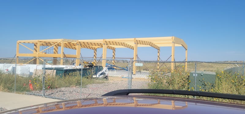

2.) I don't know the details of this one but I saw a straight up glulam PEMB a few years ago in Colorado.

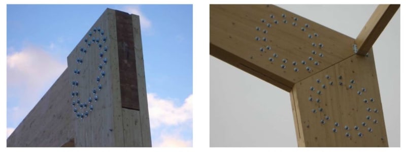

Anyway, these moment connections are relatively common around here - I'm in Estonia. But in Northern America as I can see they are not that common. Some pictures from around here - often these circular bolt arrangements are used.

@driftLimiter
Did you take that pic of the PEWB? Whereabouts in CO? Address? Maybe AHJ has an open web portal where we could find some drawings. And FOIAs are free. I am most intrigued.
From afar, it looks like they've taken the "just grab the entire end of the beam" approach for the upper part of the connection. I think I can see the edge of the knife plate in the column on the far right side.
And on the left side at the mezzanine, are those....wood braces?

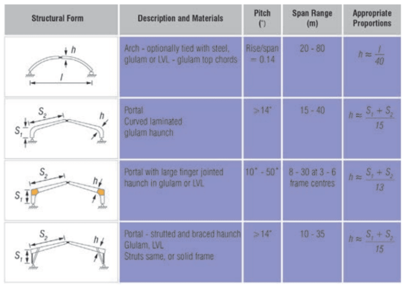

What dik says is supported by IStructE. They identify as moment connections only the following arrangements:
In my past discussions with suppliers they did mention the plate inserts as moment resisting. I guess we are on the semi-rigid connections universe, which explains the numerous bolts.

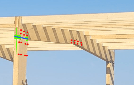

@dik From my best recollection the site is located Here
Here is a close up of the frame:
And here with the bolts in red, bearing plates in blue, and knife plate in green.
The used what appears to be a greatly thicker region of the knife plate for the tension and compression zone of the connection. Shall we proceed to cyber sleuth the site ??
