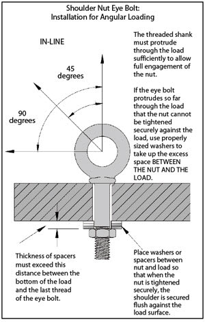

First off, does the eye-bolt have a shoulder on it, like this?
If not, you can't really apply any meaningful preload.
But speaking of preload, as long and the nut is tight and if you use a lockwasher or a shakeproof nut:
I don't think the amount of preload is going make all that much difference unless the the preload is really high. In fact, if there was a way to assure that the nut was not going to loosen, either by using lockwashers, shakeproof nut or a second jam nut, I wouldn't put hardly any preload on it. Just tight should be enough.
In the end, if you don't exceed the rating of the eye-bolt you should be OK, but there are some issues with how the load is applied. If your rigging looks like this:
Then the angle that the force is applied comes into play, keeping in mind that rating of the eye-bolt assumes that the load is being applied vertical, or in-line with the axis of the threaded section. As the angle moves from 90˚ (relative to the surface of the plate) the effective strength of the eye-bolt is reduced. And it should never be less than 45˚, as shown in these diagram:

RULE #1 in selecting eye bolts for lifting: The item description should specifically state that it's rated "FOR LIFTING". That specification will also include the "RATED LOAD", thus eliminating the need for you to make those calculations yourself. If the line of tension will not be parallel to the centerline make sure you understand the details in JohnRBaker's very fine post above.

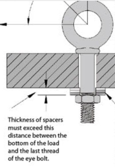

Thanks... I've only ever spec'd a single washer; is there a reason for using multiple washers...
A little slow this AM... just realised the threaded portion of the shank may protrude below the bottom of the connection...
If the load, is critical, I use Loctite Red on the threads...

We used to use a thick hard washer (not hardware store grade) under the shoulder and on the back side.
We always used self locking fasteners and tightened snug by hand wrench.
There are also swivels that you can use if angles are an issue.

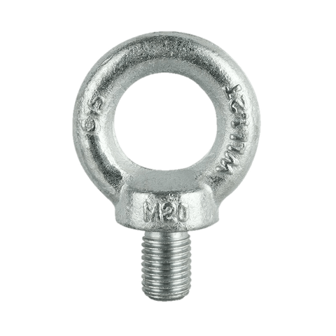

Normally a eye bolt that is rated for lifting will have the rated load printed on it in some way. something like WLL 1/4 or something like that where 1/4 means quarter tonne. If it doesn't have a clear rating like that you shouldn't use it for lifting and most safety officers will chase you off site if they catch you using them.
the picture shows a eyebolt that is rated for 1/2 tonne

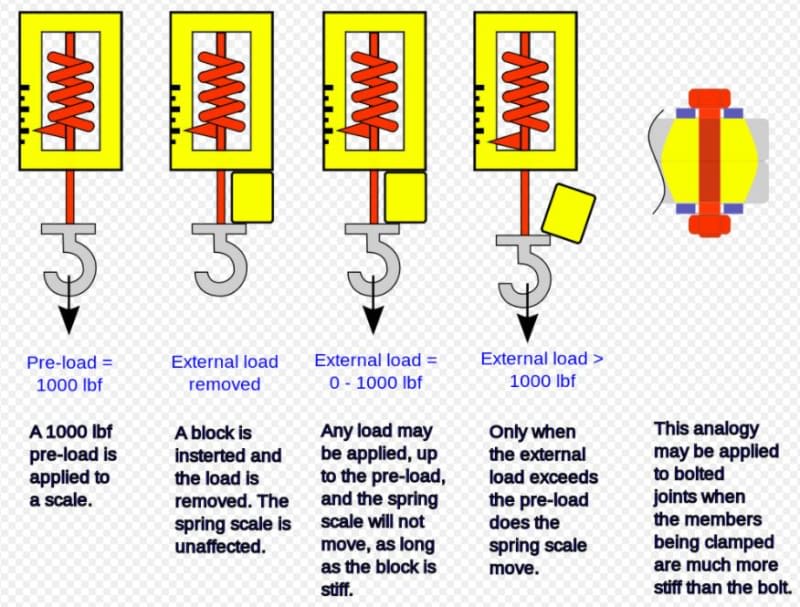

"If you torque down the eyebolt, this develops a tension preload on it. It would appear to me that any lifting force on the eyebolt would then increase the tension in the eyebolt in addition to the initial preload. Is the strength of an eyebolt then determined by how large of a preload you initially develop?"
The tension is present in the bolt whether it's coming from external tensile load or screw preload. As you add external working load, it's subtracted from the screw preload. Just like (almost*) any other bolted connection, you should have more preload than working load in all cases, or else the shoulder loses contact and the joint is outside of the design limits. If you observe the documented load limits and torque the lifting eyebolt to a reasonable spec, there will be a significant margin between max working load and overcoming the preload.
*The only place I've seen where bolt tension is additive to the tensile load is embedded / adhesive anchors installed without a nut supporting the anchored component.
David
geesman.d wrote:
"The tension is present in the bolt whether it's coming from external tensile load or screw preload. As you add external working load, it's subtracted from the screw preload. Just like (almost*) any other bolted connection, you should have more preload than working load in all cases, or else the shoulder loses contact and the joint is outside of the design limits. If you observe the documented load limits and torque the lifting eyebolt to a reasonable spec, there will be a significant margin between max working load and overcoming the preload."
Screw preload and external load seems counterintuitive at first. This is one of the best examples I've seen to explain preload vs external load. Someone posted this in another thread. I don't recall who, but they deserve the credit.
