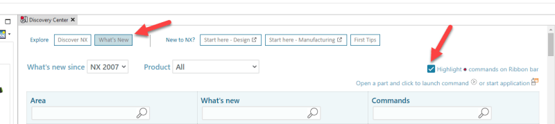

Sep 15, 2022 #1 mmauldin Bioengineer Joined Jul 16, 2004 Messages 500 Location US What does the red dot on the icons indicate?
Sep 15, 2022 1 #2 Crocostimpy Industrial Joined Jan 18, 2006 Messages 164 Location US Those are features/dialogs that have changed when a new version of NX is installed. Somewhere there's a setting to turn that off but I can't seem to find it again. I'm sure someone else will know. Mike Upvote 0 Downvote
Sep 15, 2022 Thread starter #3 mmauldin Bioengineer Joined Jul 16, 2004 Messages 500 Location US Thanks. I vaguely suspected that it might be that, not knowing was driving me crazy. Upvote 0 Downvote
Sep 15, 2022 #4 Arkance/PhoeNX Mechanical Joined Mar 2, 2010 Messages 870 Location AU It's turned off in the Discovery Centre, when it's in the What's New mode. Anthony Galante Senior Support Engineer NX9 to NX2206 (12 versions) Upvote 0 Downvote
