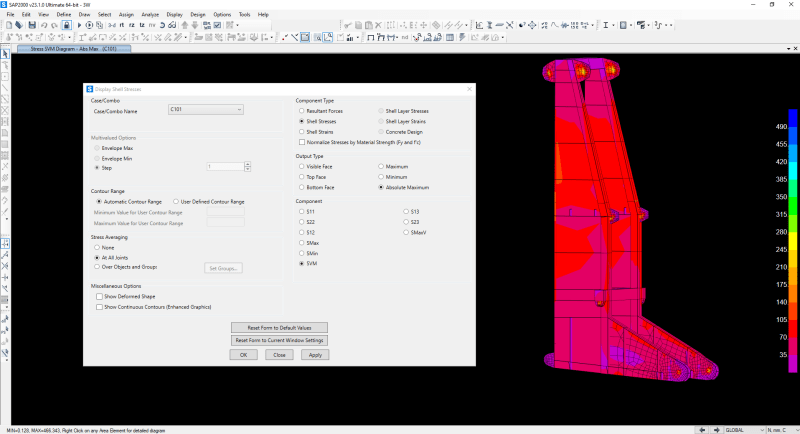

Regarding to Von-Mises stress of Shell in Sap2000, When I run load combination with Linear category, the Von-Mises stress is normal value (see Picture 1), but when I run Load combination with Envelope category,the Von-Mises stress is seem equal Zero (see Picture 2). Thanks in advance.
Consider the definition of Von Mises Stress criterion. Is it reasonable to 'envelope' this value over multiple load combinations?
Thank you for answering my problem, it seems right as you said. However, I still have not found a solution, I hope to receive your suggestions.
The solution is that you have to view VonMises for a single load case at a time that does not include envelope of any other load cases.
