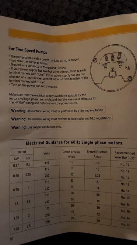

Hi all I'm hoping I can get a little help understanding the winding of a single phase 2 speed electric pool pump motor
Are the windings wired in parallel or series
Thanks in anticipation
Dear Mr. Poolworx
Please take a picture of the 2-speed motor name plate. There may be some information on the terminal connection for different voltages or different speeds. In general, single-phase motors are designed for single speed. For 2-speeds, there may be 3-4 terminal for different voltages or speeds.

Thanks Che Kuan Yau
This is the spec off eBay
Specifications
Model: VVPS215BUS
Material: ABS
Voltage: 230 V/ 60 Hz
Horse Power: 1.5 HP
Power Supply: 1100 W
High Speed Rotating: 3450 RPM
Low Speed Rotating: 1750 RPM
High Speed Max. Flow Rate: 340L per min./ 90 GPM
Low Speed Max. Flow Rate: 159L per min./ 42 GPM
High Speed Max. Head Lift: 49 ft/ 15 m
Low Speed Max. Head Lift: 10 ft/ 3 m
High Speed Amps: 4.8 A
Low Speed Amps: 2.2 A
Water Temperature: 0-40℃/ 32-104 °F
Interfaces Diameter: 1-1/2"
In your last photo, the common would seem to be the black wire?
Looks like it then a mixture of a 4 pole (low speed) or 2 pole (high speed) motor
So from that i came up with a newbies electrical diagram so please bare with me :( The first one is hoe i interpreted the 2 main windings Hi & Low sped as being wired in series. The second is the same but wired in parallel
So im trying to figure would the internal run windings be in series or parallel
Thanks again for every ones input much appreciated
