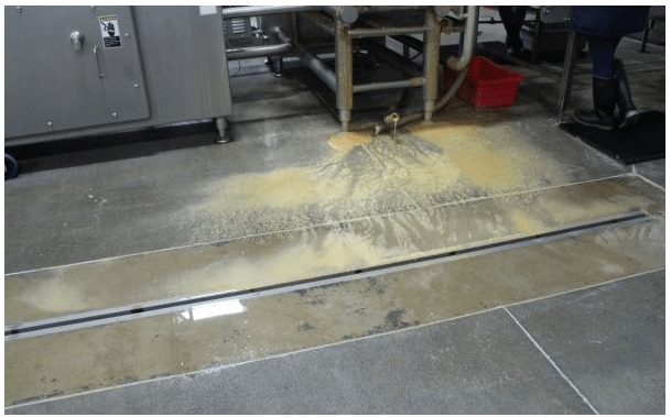

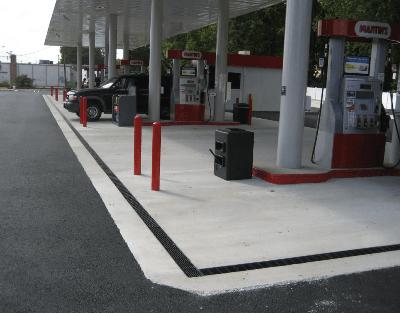

Hey everyone,
Thanks for the feedback. The transport of chemical waste via trench drains are quite common at the facility I am working at and at other locations. Please see the pictures below for some examples. My main concern was using a trench drain for long distances. I have opted to recommend to the client to only use the trench drains where collection of chemicals are needs and to use a buried pipe at all other points. The main reason will be that trench drains requires more maintenance since they collect debris. Especially since the project site is outside. I also brought up evaporation of the chemicals as a potential concern as well.
2022-08-31_15_14_17-Slot_Drains_vs_Trench_Drains__7_Advantages_of_Slot_Drains_Over_Trench_Drains_and_gepctq.png
2022-08-31_15_13_32-Trench_Drains_and_Slotted_Drains_for_Gas_Stations_and_Fueling_Stations_I_USA_I_E_hkdywv.png
Regards.
your second photo indicates that fuel could spill and be caught in the trench drain [and then perhaps catch fire]. in my experience, there are NFPA rules that may affect this design. similar designs on airfields required fire stops at intervals between runs
