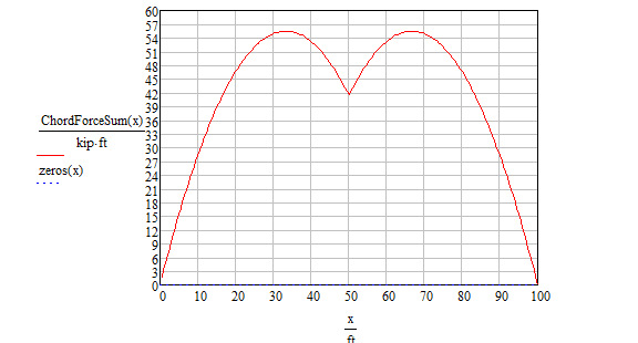

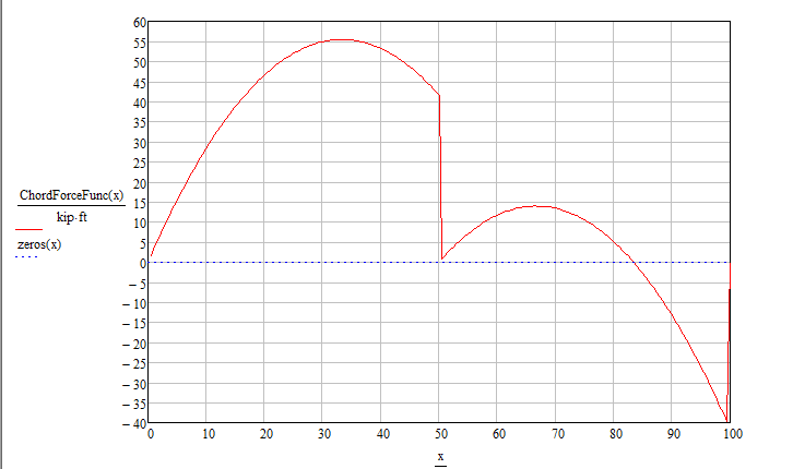

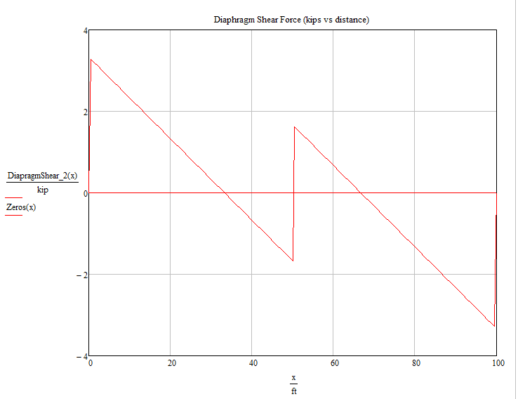

I have gone through this in mathcad 15 and mathcad seems to struggle with integration over a discontinuous function.
I was able to solve this by integrating of the continuous portion of the function and then adding tip to tails to connect the discontinuous regions.
Shear diagram (discontinous function)
Integration over continuous portions:
Adding tips to tails to make a final graph:
You can probably do something similar for your example.
