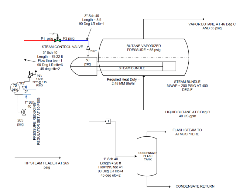

I'm not sure I understand what you are trying to do . Your system should include the steam valve . A sketch will help .

pierreick,
Please refer to the previous thread, link copied below. The sketch is also provided in the previous thread.
My goal is to specify the upstream and downstream pressure of the Steam Control Valve in question for three different flowrates. The inlet line is 3" Sch 40 CS pipe, 79.7 ft long with some fittings. The line is insulated with 2" mineral wool. The outlet line is just 3 feet long, also 3" Sch 40 CS. As you can see the calculation of the upstream and downstream pressure depends on pressure drop. HP steam at 265 psig is step down to 70 psig across a let down regulator which then flows to the steam control valve through the 79.7 feet long 3" pipe . The question I am asking is using adiabatic model is giving a pressure drop higher than that calculated using the Polytropic approximation. The line is long and insulated so adiabatic model cannot be used as per your guidance. So the polytropic approximation is adequate then?. Besides the result from the polytropic approximation calculation is the close the value calculated using AFT Arrow software. The other question I asked is to calculate the temperature of the steam at control valve inlet I have to take in account of the heat loss through the pipe with insulation?. I have detailed the methodology in the previous thread.

Hi danschwind,
As you can see in the attached sketch there is a PSV on the line downstream of the regulator that is set at 115 psig. The steam bundle's MAWP is 200 psig at 400 Deg F. I want t calculate the pipe schedule for the 3" pipe using the pipe pressure design formula given ASME B31.1. The maximum pressure the line for the regulator failure case would be PSV Set pressure + 10% overpressure which is 1.1*115 = 126.5 psig=141.2 psia. I want to make sure this is correct.
Thanks and Regards,
Pavan Kumar

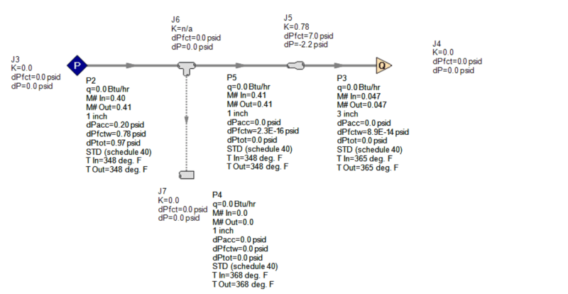

Hi danschwind,
I have question on the pressure drop calculation done by AFT Arrow for pipes and fittings. I have a 4" long 1" Sch 40 pipe ,followed by 1" equal Flow thru Tee and then a 1"X3" concentric expander. I calculated the pressure drop through by spreadsheet with those calculated with AFT Arrow.
Flow rate = 2661.1 lb/hr pressure = 70 psig, Temperature = 175.79 Deg C
Using my spreadsheet:
1" Sch 40 pipe - 4" long : DP = 0.62 psi
1" Equal Tee : DP = 3.309 psi
1"X3" Conc Expander : DP = 6.219 psi ( K= 0.837)
Total DP = 0.62+3.309+6.219 = 10.62 psi
the calculated pressure drop through the Tee and the 1"X3" expander seem to be high and I compared it with AFT Arrow. The results are copied below.
Using AFT Arrow:
1" Sch 40 pipe - 4" long : DP = 0.97 psi
1" Equal Tee : DP = 0 psi ( does not calculate even though I used the detailed model and arranged the side branch ccrrectly )
1"X3" Conc Expander : DP = 7 psi (K=0.78, DP friction = 7 psi, wile DP Static Total = -2.2 psi. I want to know why DP Static is - 2.2 psi when DP friction = +7 psi?)
The pressure drop through the 4" long 1" Sch 40 pipe and 1"X3" conc expander are close. There is a question on the difference between Static pressure loss and frictional pressure loss for an expander which is not clear to me and would want your inputs. Also want to know why AFT Arrow is not calculating the pressure drop in Flow Thru Tee. I have attached AFT Arrow file for your reference.
Thanks and Regards,
Pavan Kumar
I can't say why the software is not calculating the pressure drop through the tee. But, a straight flow through a tee is pretty much a straight pipe.
I'll refrain from trying to explain what the software is doing because I don't work for AFT. Maybe they can assist you through their support.
Regarding your non-software related question, frictional pressure drop in this case is related to how much stagnation pressure (static pressure + dynamic pressure) you lost. When the fluid goes through an expander, it will lose stagnation pressure due to friction but will gain static pressure because your velocity will be lower (hence less dynamic pressure). So, even though your net stagnation pressure is lower, your static pressure might be higher.
Static pressure you measure with a pressure gauge, stagnation pressure with a pitot tube.
Daniel
Process Engineer
Rio de Janeiro - Brazil
Hi danschwind,
If I am not wrong Static pressure is the flowing pressure?. When the fluid flows across an expander it loses energy due to friction and also becomes slower. If an energy balance is done the energy lost in friction(permanent loss) and slowing down(recoverable loss) should be taken from the static pressure. In that case the static pressure should reduce and not increase. So the static pressure difference should be positive and not negative correct?.
From what you say the stagnation pressure difference is the true pressure loss due to friction that I should consider?. From AFT Arrow file when I checked to see the stagnation pressure difference it is same as the DP,Friction = 7 psi.
Thanks and Regards,
Pavan Kumar
Just think of the equation:
Stagnation pressure = Static Pressure + Dynamic Pressure
When you lose pressure/energy due to friction, you are decreasing the overall stagnation pressure. Stagnation Pressure After = Stagnation Pressure Before - Friction Loss.
If you slow down the fluid in a reversible manner (no friction loss), you are decreasing velocity and therefore increasing static pressure to keep the stagnation pressure the same.
So, as I said, in a expander you are basically losing some Stagnation Pressure but also trading some Dynamic Pressure for some Static Pressure.
Even though in a compressible flow this gets a little bit more complex (in your scenario it is pratically incompressible, so anyway), if you think of the Bernoulli Equation it gets pretty easy to understand what is going on.
Daniel
Process Engineer
Hi danschwind,
I need to calculate the static pressure at the exit of the 1"X3" conc expander as seen on the sketch attached. I am calculating the pressure between the sensing line of the regulator where the static pressure is 70 psig and at the exit of the 1"X3" expander. The pressure drop is due to the 1" Flow thru Tee and the 1"X3" expander which I calculated as 3.31 psi and 6.22 psi respectively. So the pressure downstream of the reducer will be 70-3.31-6.22 = 60.47 psi. I then have to add the increase in static pressure due to lowering of the velocity to get the correct static pressure at the exit of 1"X3" reducer.
What I want to know is how do I calculate this increase in static pressure due reduction in velocity.
Thanks and Regards,
Pavan Kumar
