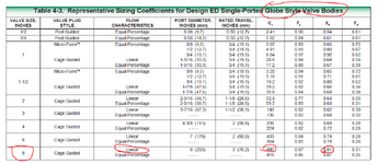

I did some preliminary Control Valve Sizing Calcs (spreadsheet attached) using Emerson Control Valve Manual and got a size of 8" with a required CV of 568 with a rated CV of 846. The line size would then be 10". The header is 16". I have also asked TLV to size the control valve to get the correct Control Valve based on their selected trim.
On side note Emerson Control Valve Manual has data only up to 8" size Globe valve style control valves. If size bigger than 8" is required what does one do?.

The 8" Globe Style control valve 100% CV of 846 is based on my preliminary calculation using Emerson Control Valve Technical Manual( same as the one shared by Mr. Pierre).
I will verify with TLV rep when I get the data sheet from them for the max open CV. As I said in my previous post Emerson Manual provides, CV, XT values only to 8" size. For me to do manual sizing I can only go up to 8" Globe Style Valve. See CV table below from Emerson Control Valve Technical Manual. I wanted to ask again what I should do when my required CV is greater than 846. Mr. Goutam suggested using Double port valves but I am not sure how to use that in my calculation spreadsheet.

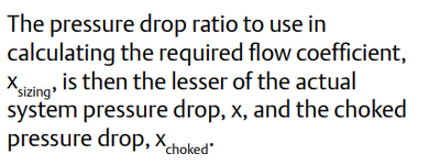

From your calculation:
From my reference (https://www.emerson.com/documents/automation/control-valve-handbook-en-3661206.pdf) the same should be:
So your X should be x_sizing
And
Please check with your reference
Hi Mr. Goutam,
I have taken care of this requirement as the minimum value of expansion factor Y is 0.667. In my case XSizing(= 0.899) is greater than Fk*XTP (=0.919*0.774=0.711), so I have equated XSizing to Xchoked(=Fk*XTP) to get Y=0.667.
